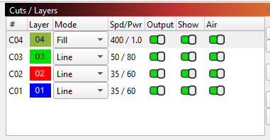

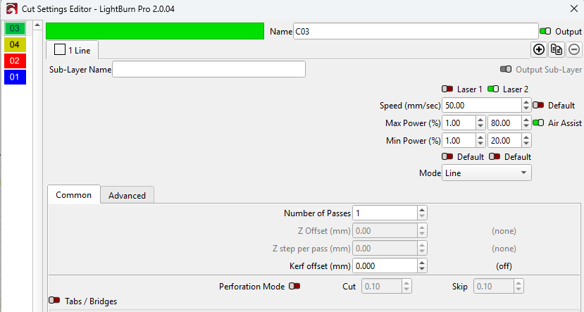

So..
All colors are Laser 1, except CO3 which is Laser 2.
I would expect Lightburn to enable me to select this..

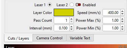

So I go to C04..
That has Laser 1 selected.. Correct.

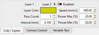

So I go to C03.. which has laser 1 selected.. I select laser 2..

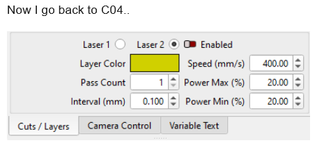

Now I go back to C04..
Whoops.. Lightburn has changed this to Laser 2??? WRONG
I beleive I have these setting correct..
But it does not matter if I set the Only One Laser at a time ON or OFF.
Sorry for being tense but I have a job with 2 lasers.. to make 100 pieces out of one board, and I do not want to run the job twice for 1 Laser and then Laser 2..
Ask your programmers what their ide of this was.. I will be using bother lasers for different parts of the jobs and this us VERY important to me.

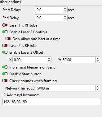

just my 2 cents: I believe you have to enable dual laser on all layers

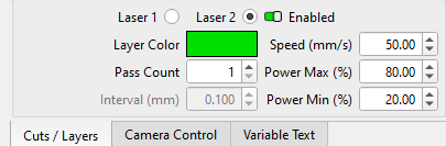

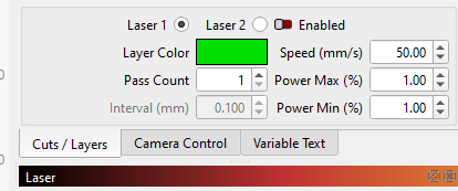

Sort of found something..
Totally ignore what this says..
and only rely on this..
That seems to work..
If the two can be synced together it be a help.

The initial way that most dual-tube systems worked is they had two laser heads which could be operated at the same time, in parallel.
The radio buttons (Laser 1 / Laser 2) are not selecting which laser is enabled, they’re selecting which laser you’re editing the settings for. You can enable both tubes at the same time, allowing you to cut two of the same object side-by-side with a dual head laser.
Significantly later, manufacturers started adding complex mechanisms to allow one beam path and one laser head in a machine, and asked for us to add the ability to force only one tube in use at a time.
Enabling the “only one at a time” guarantees that the “Enable” toggle will only be turned on for one laser at a time, but you still use the radio buttons to choose between the lasers.
I thought I had made the radio button “auto-switch” to whichever laser was the active tube. I’ll have to go double check that.
I suspect when you say “ignore this” you mean the power values in the power/speed column? I believe those do only show laser 1 values, but that could be changed so if you have “only one tube at once” enabled to show the 2nd power value if chosen.
Ok.. And Many thanks.
I understand a little better now.

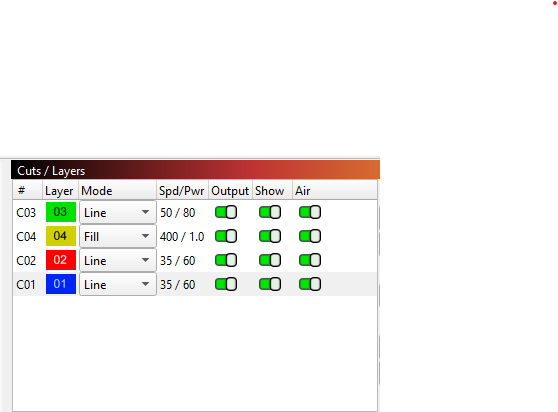

Currently I am only using the main ‘Color’ edit page.. and ignoring the smaller one under the Cuts/Layers.
If I need to disable something I use use the Output toggle for each Layer. Plus ensuring Enable is always turned on.
It would be fantastic to add on the Cuts/Layer list which Laser is activated for each Layer.
Hope I am getting the terminology correct.
Again thanks for your valuable time :slight_smile:
Dave
I have modified the code to auto-select the appropriate laser1/laser2 radio button if only one output is enabled. If you want to switch to the other tube you still have to click the other radio button and toggle the ‘Enable’ switch to turn it on.
