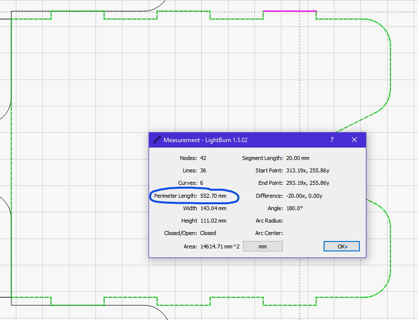

Would the ‘Measurement’ tool work for you?
Or if you want a total cut length you can check it in the preview dialogue.
Hope this helps.
As Markus said above, the measure tool should get there, but you may have to build temporary “construction lines” or duplicate isolated areas to extract the information. For example, if you have a partially thread screw cross section that is a single closed loop and you want to find the thread length, you would draw the red line and “measure” that. Or if you wanted the path length of the threads, you could duplicate the screw and delete all but the area in green. Etc.
Although, I prefer to create technical geometry in a separate CAD application and import the DXF from that into Lightburn. The CAD software is faster and more precise for me when technical design is required.
