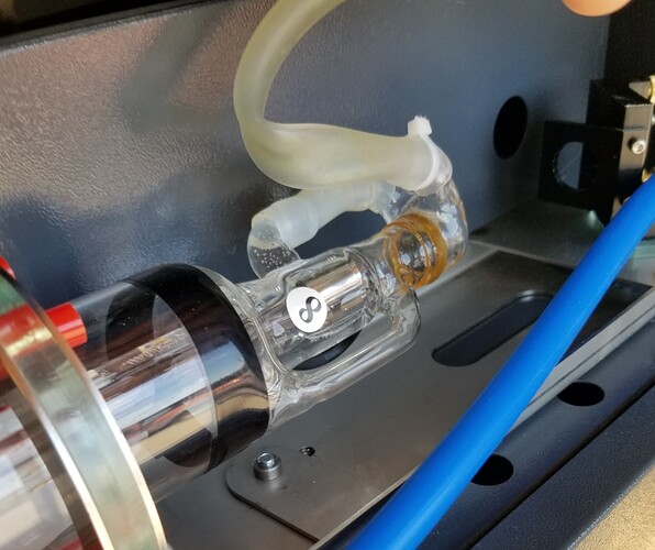

Here is the business end of my tube. I do not have it grounded, nor not sure how to go about that to be honest.
You’ll also notice some small air bubbles. I’ve got to get a chiller, which probably has nothing to do with bubbles, but put in a drop or two of dawn, and I get these everything now and then. Pinching the inlet hose does break them up some and they release into the return, but the only way I can rid of them, is to pull the tube out of the braces, and tilt it while the pump is on.
Tube End
https://drive.google.com/file/d/15MRacoEWIQzFiLT7b0ToPeOVG5SLS4vE/view?usp=sharing
The black wire leaving that end of the tube (cathode) is grounded or it wouldn’t work… It may go through a mA meter, but it should be at ground potential.
You should rotate your tube so the coolant will take any bubbles out of the tube… So the outlet should go up…
