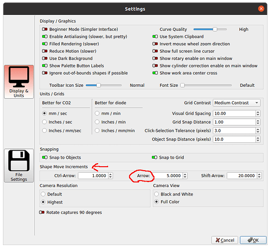

I think these can be changed here… I know it works when I move a shape with the arrow keys… Doesn’t seem to relate to the tool bar size up/down arrows.
It seems to have no effect. It seems to only change in 10mm increments or the inch equivalents.
