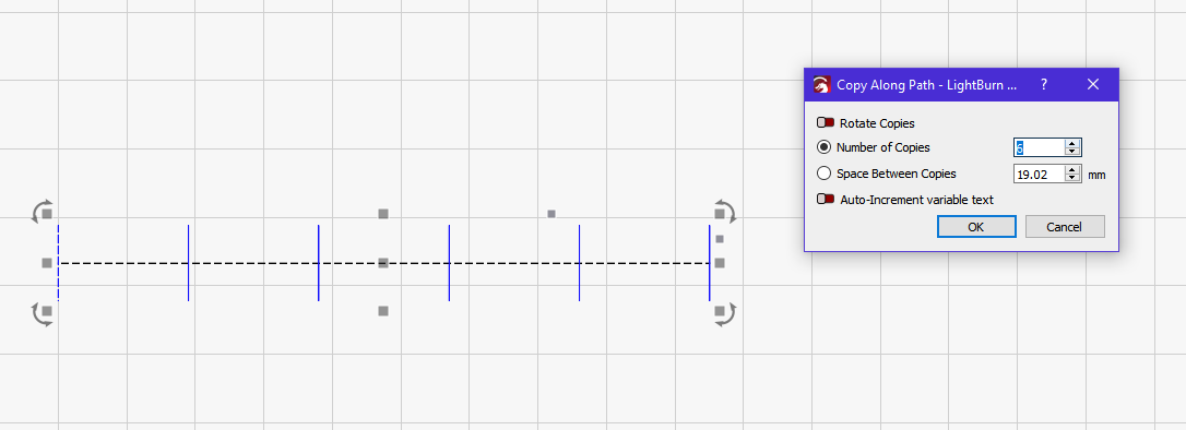

How do I divide a line into equal sections, say 4 or 5 or 9 o whatever?
I ask because I use lightburn to design buildings for my HO scale model trains. If I want to have a building front with several equally spaced windows, I need to find a fairly simple way to accomplish this, rather than the trial and error method I’ve been using.
Same goes for windows. If I make a window a scale 6 feet wide, and I want to have 5 individual panes going across, how do I do that?

I’d suggest looking at these two tools:
  1. Grid Array Tool - This will allow you to create copies of a shape in various ways with a tremendous amount of flexibility
  2. Arrange->Distribute - This will allow you to distribute existing shapes evenly. If you position the two pieces at the extremes of the area you want covered this tool will distribute all the shapes evenly between those extremes
This is my first thought:
  1. Draw a ‘cutting’ line and place it at one end of the line you want divided.
  2. Select your cutting line first then select the line you want divided using either shift-click or ctrl-click so that you have both lines selected (the selection order is important!).
  3. Use the ‘Copy Along Path’ tool to copy your cutting line as many times as you need.
  4. Then use the ‘node edit’ tool to place nodes at the intersections of you main line and your cutting lines.
  5. Lastly, delete your cutting lines.
Hope this helps.

However. I tried what you said. I drew a horizontal line and a short vertical line at one end, just touching the horizontal line. I selected both lines and when I used the “copy along path”, I got more horizontal lines corresponding to the length of the vertical line.
Any thoughts about what I’m doing wrong?
Alan Carter
It’s important to select your lines in the correct order (I should have highlighted that fact). Select the short line first and the line you want to divide second.
Great. That worked. I also forgot that you have to press “shift” when you click on the second line.
Thanks for your help. Problem solved.
