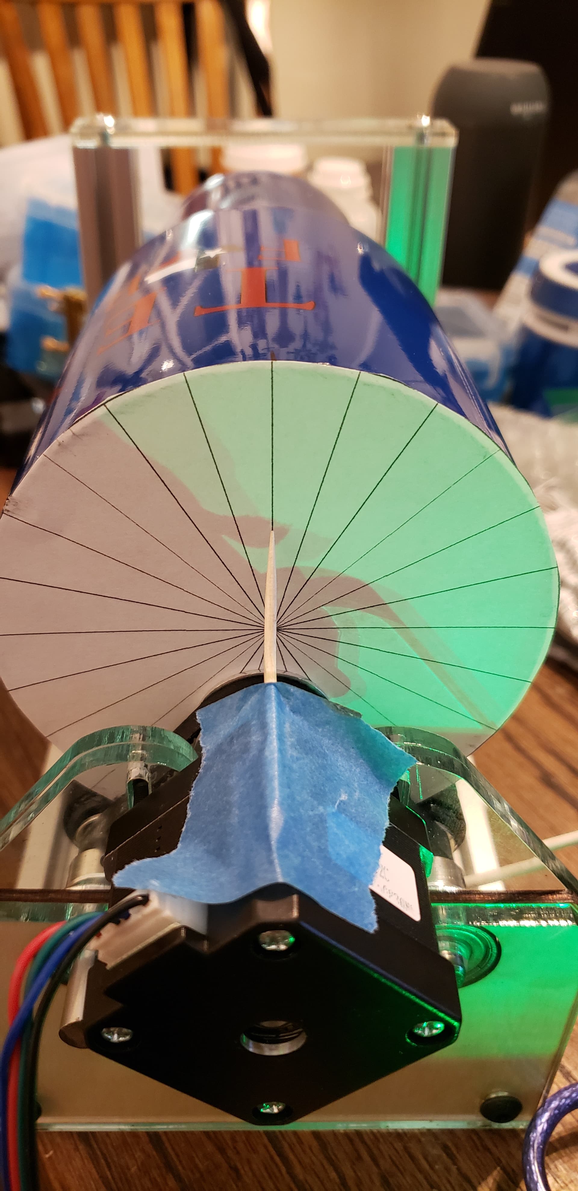

rotary design
Thanks for the pictures … we all love them…
Nice rotary too…
Well thank you
