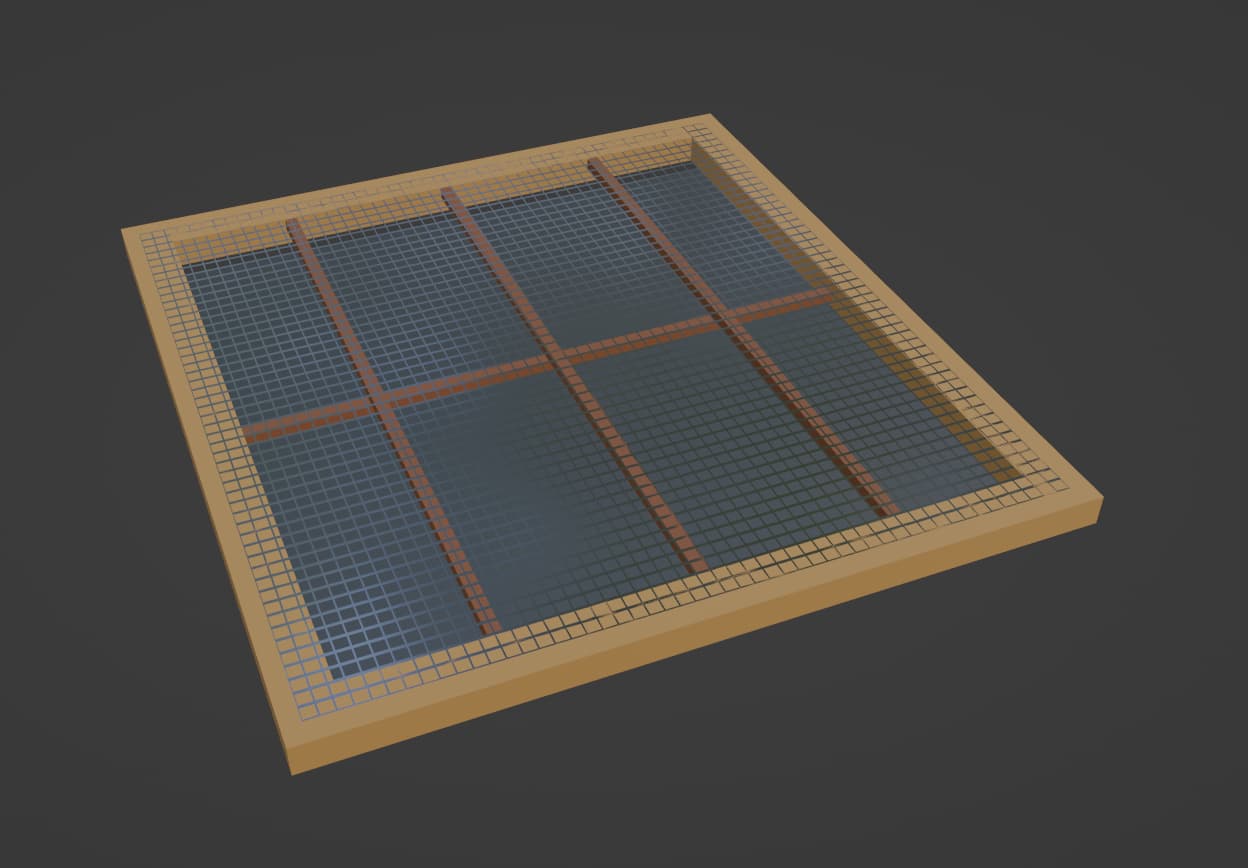

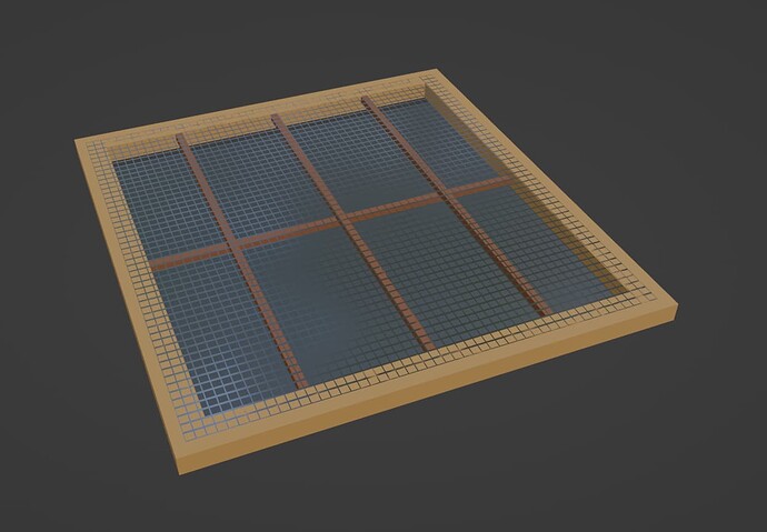

I have a Sculpfun S9 and got it in a bundle with Honeycomb bed. However this bed is only 40x40cm big, limiting my capabilities greatly. I looked online for some bigger ones but the prices are just ridicolous! So i thought of making my own for about 20€. This is what i threw together really quickly to give y’all an idea of what i have in mind:
The frame would be from wood, screwed together and just big enough and have the right shape for the laser to sit on it. Then, as a bottom protective layer i would use galvanized sheets of metal, i can get 500x250mm cheaply so i would just get two and use them and fill the small gaps on ends with tinfoil or just wont use those few cm’s. Then on top would be galvanized hardware cloth with eye opening of 12mm approximately, and to support it and stop from overhanging i though about playcing 10x10mm small wooden pieces, support them in the middle with one extra going the other direction.
Would this be a good idea? Any other ideas what to do to utilize whole sculpfun cutting area? Won’t the zinc on mesh and steel plate make problems? What about the lack of gap where the support 10x10 wood would be? And won’t that wood be burnt and break over time? (maybe if i cover the top sides with tinfoil as well, it would protect the wood but then there’s problem of charring on the back of cutting piece again…) And also, wont the sheet metal reflect the laser and damage the wooden piece that’s being cut?
Thanks in advance for any help and insight!
There is a simpler, cheaper and better solution.
In most hardware stores, you can buy perforated steel plates in various designs and sizes. Get a plate cut to the size you need and threaded rods or bolts as legs. The plates are typically one or 2 mm thick and made of black steel or stainless steel. They must not be galvanized, the laser burns zinc off the galvanization.

If you are using hardware cloth for the mesh, I would caution on two points.
Hardware cloth is often galvanized and that is not something you want to be using.
Secondly, I think that it would be a challenge to get the hardware cloth to lie perfectly flat. If it doesn’t that’ll cause problems with clearance and focus.
Never use Galvanized steel with lasers, welders, plasma cutters or anything that has the potential to melt or vaporize zinc, the fumes are highly toxic.

Any wire mesh will eventually droop, and a wooden frame will bend or flex.
The wires that catches the laser beam will also distort/deform sooner or later, that’s one of the reasons honeycomb beds have depth in order to reduce or even eliminate that effect.
Much more rigid than wire mesh.
While a perforated steel plate is a lot better alternative to a honeycomb bed than a wire mesh, a one that’s perforated enough to make a difference will be guaranteed to be relatively expensive.
So, even as a someone who’s been a diyholic since the ripe age of 5 or so, I don’t think there’s a feasible DIY alternative to a commercial honeycomb bed.

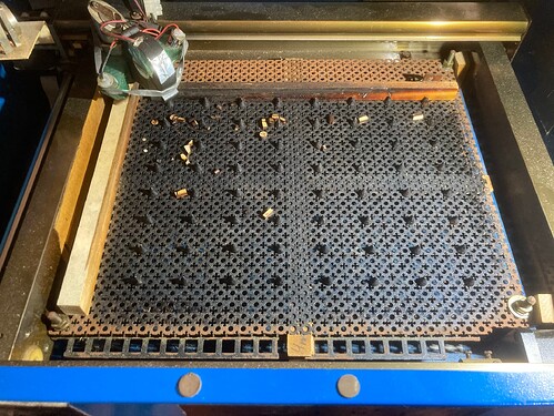

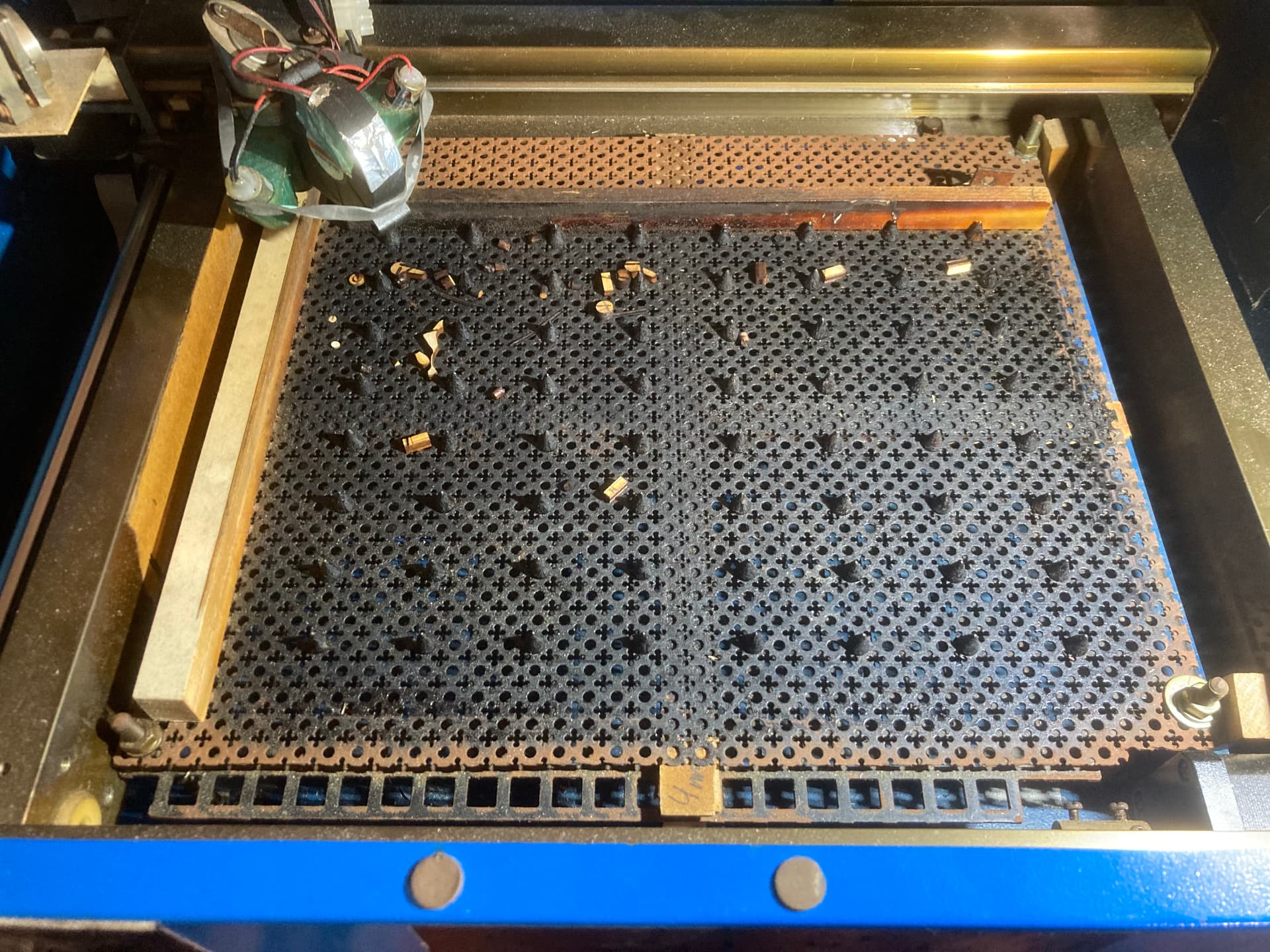

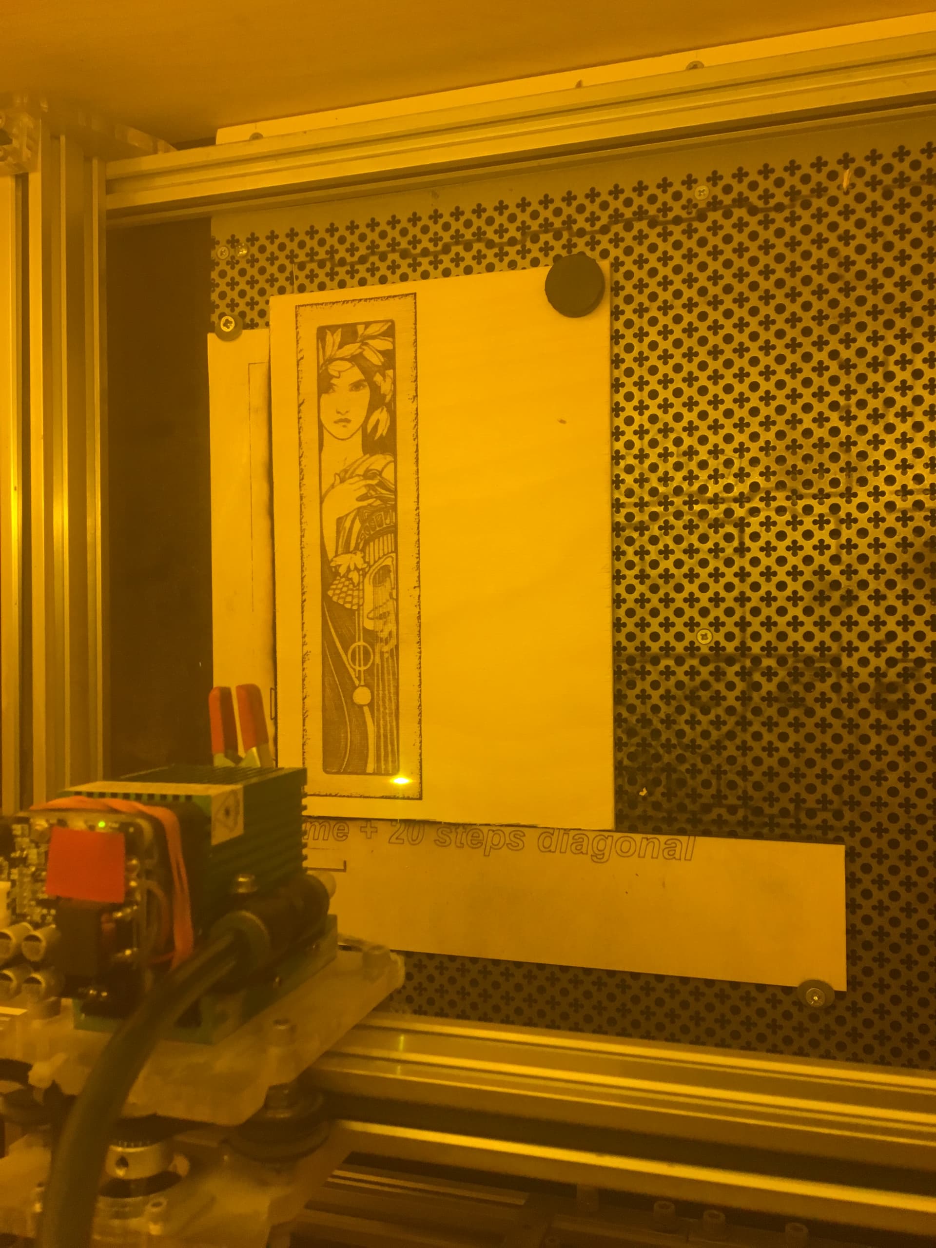

Here are pictures from my old machines, with self -built machine beds for lasers.
The material is very stable and it can be adjusted with adjusting screws until the plate is completely straight.
The price for perforated plate is here approx. 35-50% of what a honycomb costs.
The second last picture shows how important it is with a functioning extraction and enough space under the hole plate - here there is none of it. :wink:
I’ve used this solution with punk spikes also in my CO2 laser at first (last photo) but thought it will be even better with a honycomb … the money I could have saved, both solutions work just fine, if only there is a distance during the plates and there is enough in and out air.
Fortunately, the grease stains seen in the last picture, I have no more, it was before I installed my external suction. The vent pipe can be seen on the left, I moved it from the back and it gave me a significant improvement of air flow in the machine.)

Thanks very much to all for convincing me that the zinc would be a problem … before it actually was. I made my own with the steel mesh which is certainly zinc coated. It was more trouble than I imagined, but I did get it built. I’ve just gone back and bought a the honeycomb from the laser company to match the footprint. I should have saved myself all the trouble.
I forgot about this thread too! I found a deal on Banggood, 35€ for 500x500 aluminum honeycomb, so i ordered that right away and all problems solved.
