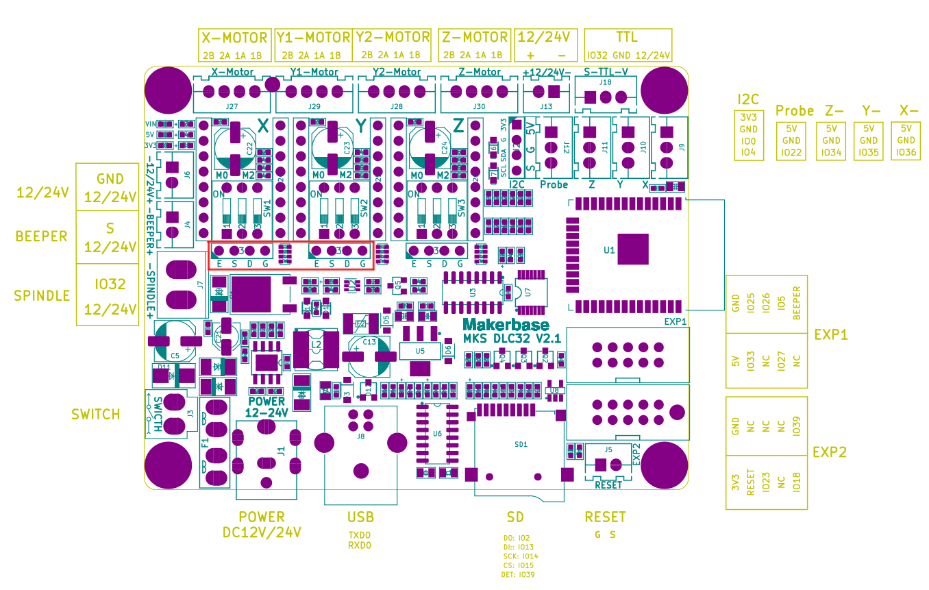

I run mine DLC32 on the desk, not in a machine or with driver boards. I ran mine directly to the stepper motor drivers. They are separate in my machine. I’ve never used the boards motor drivers.
I use the outputs here, in red, for the motor driver.
Hopefully @misken can help you out with the current setting of the driver, he’s got a lot of documentation and time with grbl type boards.
