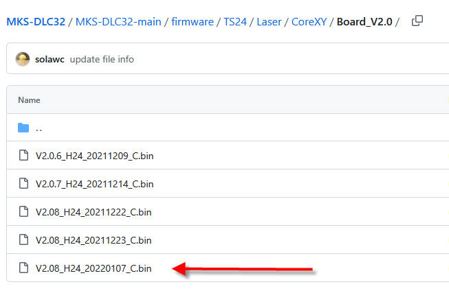

I was completely unaware of this detail… :open_mouth:

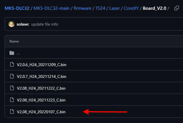

I use this one
V2.08_H24_20220107_C.bin
Yes, that should be correct then :slight_smile:

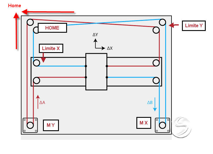

After many exchanges on the forum and many proposals and various tests, I take stock of my worries and various malfunctions Kinematics Core XY, MKS DLC32 V2.1 board, MKS TS24 rev 2.1 display, available dimensions 400X400mm, use of the latest version of LightBurn 1.7.08
I attach the plan of the kinematics, I would appreciate confirmation of the correct definition of the X and Y axes as well as those of the stops for the Y and Y homming

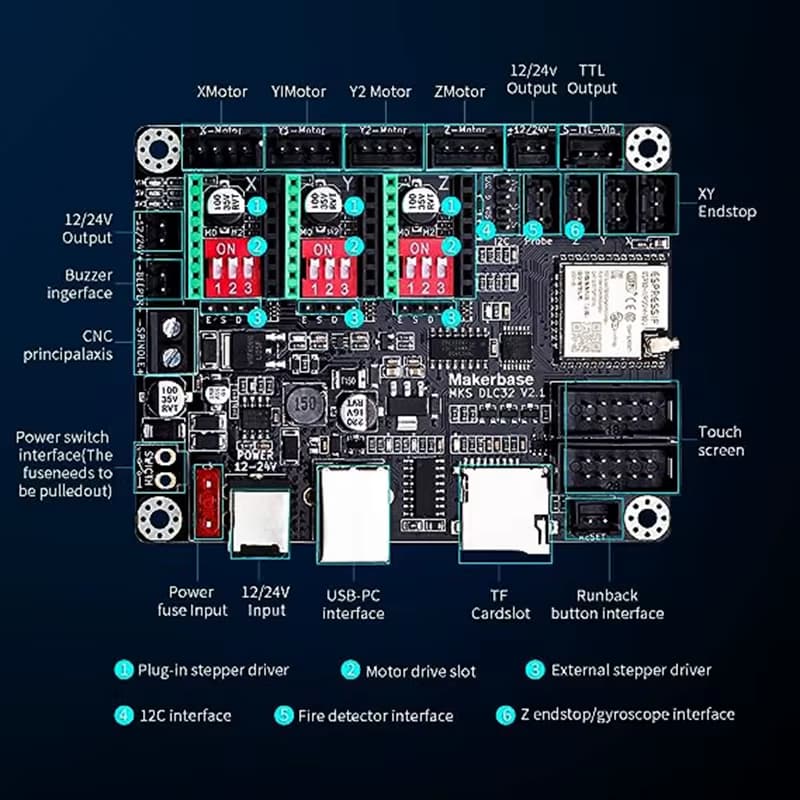

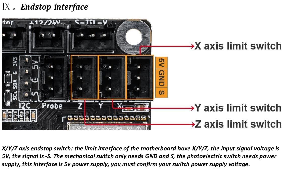

I am kind in a hurry, but I leave you an image of the MKS board where you identify the ports (connectors) for limit switches (up right). Of corse you have to eneble them by software later.
I am not familiar with thathose limit switches so I can’t guarantee at this moment if they are compatible or not.

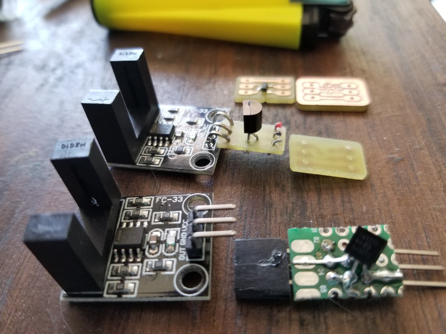

These appear to be optical interrupters, not hall effect switches. These require some type of object to go between the two posts and block the IR from the sensor.
These all have wiring diagrams and most just pull a line low. If you want them pulled high, then you have to change the configuration.

I have already connected the two stops X and Y to validate the homming in 0.0 and this on the dedicated connectors (endstop X and Y).
My question was: if I put two other stops for the MAXI limits of X and Y, how can I do it when there is no connector for it, maybe connect them in series, but how?

From what I understand, the limit switches connected to the connectors mentioned in the image are “Hard limit switches” or “MAX” as you called them and are used for “homing”. The “Soft limit switches” are actually reference values ​​that serve as a warning when working too close to the “Hard limit switches” but which are not actually physical switches. When I assembled mine I was thinking about the same problem and this was the conclusion I came to. I don’t think I’m wrong, but if someone more knowledgeable than me on the subject has something to correct or add, please do me a favor and explain the matter better than I can at this time.
If you use normally open (NO) switches, parallel them, if normally closed (NC), series them.
I don’t know what kind of output your interrupters are, but the ones I got went active high, I needed active low, so I added an inverter mosfet.

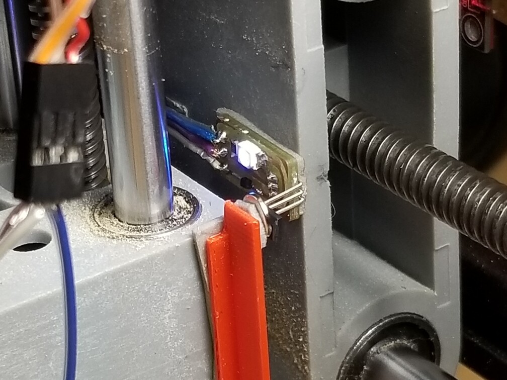

After a piece of debris was thrown into the interrupter, I went to a Hall effect type of detector.
If you’re going to use electronic type switches, then I’d suggest you use NO which have an open collector configuration allowing you to parallel their operation to pull a pin low. Many of these have both options available.
The software limits should keep the machine off these, if they do become active the machine has lost it’s location and will have to be re-homed.

On the other hand, what bothers me is the control of the Y which is reversed on the MKS TS24 screen.
I’m going to do various configuration tests of the axes to see if I find the solution. I ordered an MKS TS35 screen, I’ll see if it works out.

Parameter $21 is only if you have switches on both ends of each axis. It should be $21=0.
$20 is for using the controller software to limit travel along either axis. It uses the $130 and $131 parameters to establish how far you can go. Without limit switches, it should $20=1.
If you hit the frame using soft limits, reduce $130 and $131 a little bit until it stops without banging and gives you an error message somewhere.
A HARD limit will require a Home cycle to clear it.
A SOFT limit will stop and you can Jog off the limit. A Home cycle is not required.
