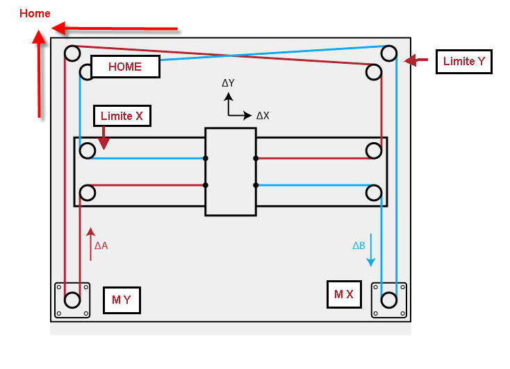

Hello After several tries, impossible to adjust the displacement of the limits, my chassis is 400*400, I put 390 in $130 and $131, on each axis this limit is exceeded. Maybe I don’t apply the instructions to the letter!! I attach the sketch of my structure, I want a home at the top left. I have configured this information in lightburn. Looking at my sketch, I would like to know if the X and Y motor assignment as well as the X and Y boundaries are positioned correctly. Would it be possible to have a valid *.lbset file that would match my configuration, I could do a test and if it works properly compare it with mine. A beginner in perdition.

Is this your mechanics? This actually IS a CoreXY-mechanic, then you need to use a different firmware (the corexy one, not the normal one).
