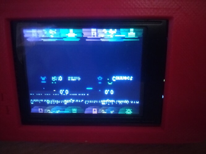

2 - This firmware is intended for boards with a 3.5" display
however, the board works even without the display. Also works with a 2.4" display
but it becomes unreadable due to the firmware settings being for 3.5"

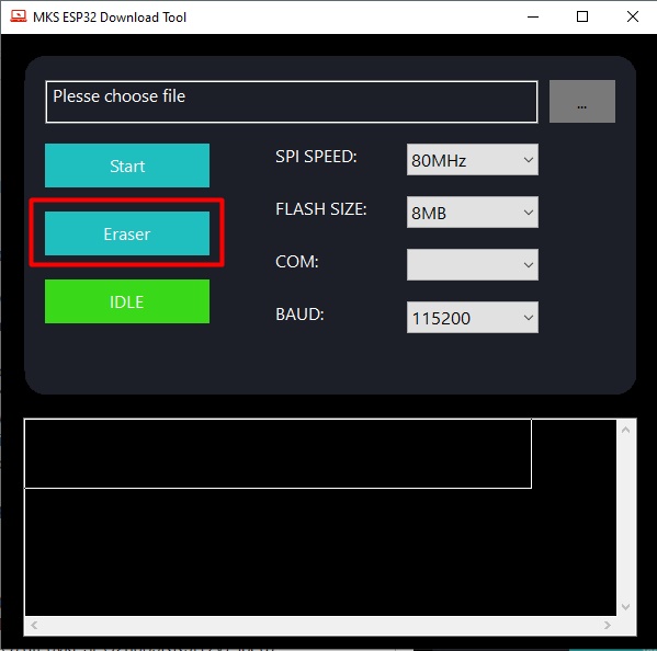

What was done:

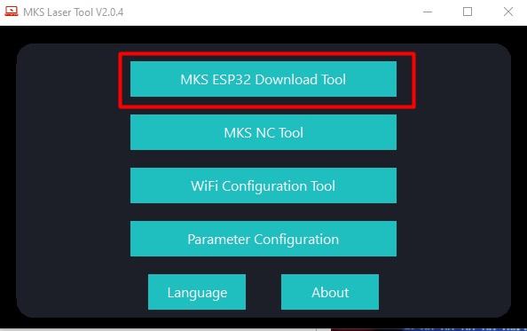

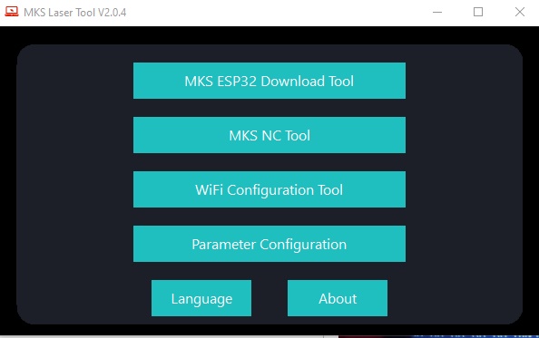

1 - With MKS board connected to computer, through the software MKS Tool
mkstool01
select
mkstool02
then select
and delete de existing firmware.

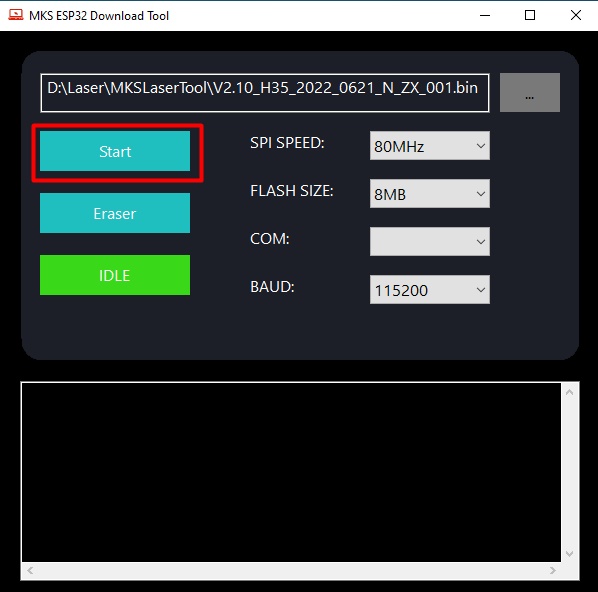

2 - Then install the new firmware.
Select the new firmware file
and hit Start
When finished reboot the board.
