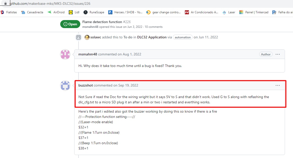

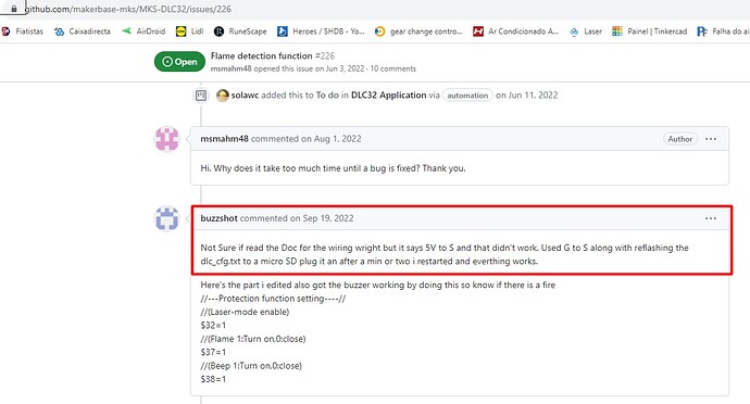

I came across this knowledge in a Github thread:
From what I’ve been able to find out so far, the card will not be activating the function. This is because simulating the signal from the flame detector directly on the port of the board while a job is in progress, the LB “Console” window does not show any warning or information even when the “show all” option is activated.

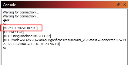

Apparently I’m using version 1
version01

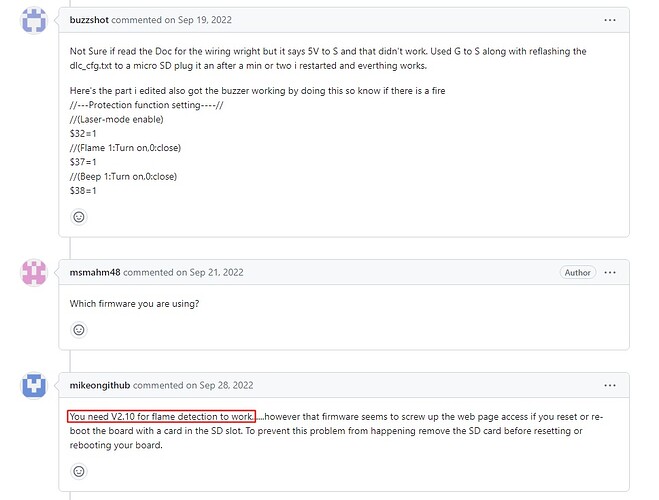

and apparently I need to install version 2.10 of the firmware
Ok,…
Now,… I’ll just confirm that I’m not using the appropriate version, install an updated version (at least 2.1) and I’ll come back to give feedback. :wink:

I finally did it!
So I’ll leave here some notes and an explanation of how it was possible.
Notes to take into account:
1 - Only firmware V2.10_H35_2022_0621_N_ZX_001 supports the “Flame Detector” function through the signal on the “Probe” port.
(Moderator Edit: Corrected Typo at Kuth’s request
Technical reference: Flame detection function · Issue #226 · makerbase-mks/MKS-DLC32 · GitHub)
2 - This firmware is intended for boards with a 3.5" display
however, the board works even without the display. Also works with a 2.4" display
but it becomes unreadable due to the firmware settings being for 3.5"
3 - Use a flame sensor with output at 0 in case of alarm. (positive in normal mode)
Otherwise it will have to be changed as happened to me. (Image at the end of the video included in this thread)
