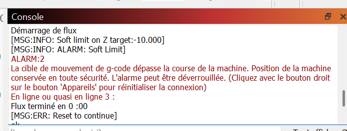

Hello, I need your help to resolve my programming error. I don’t understand the error message in Light Burn and I don’t know what to change in FluidNC to fix it.
Thanks in advance.

The error message means that you tried to send the z axis beyond its limits. You might have inverted the settings im LB maybe. According to your settings, the z-axis can be used from 0 to 63mm. But you sent it to -10mm. So this is out of range.
You can disable soft limits for the z-axis, so the error is gone, but it’s better to check your setup where you mixed the directions.

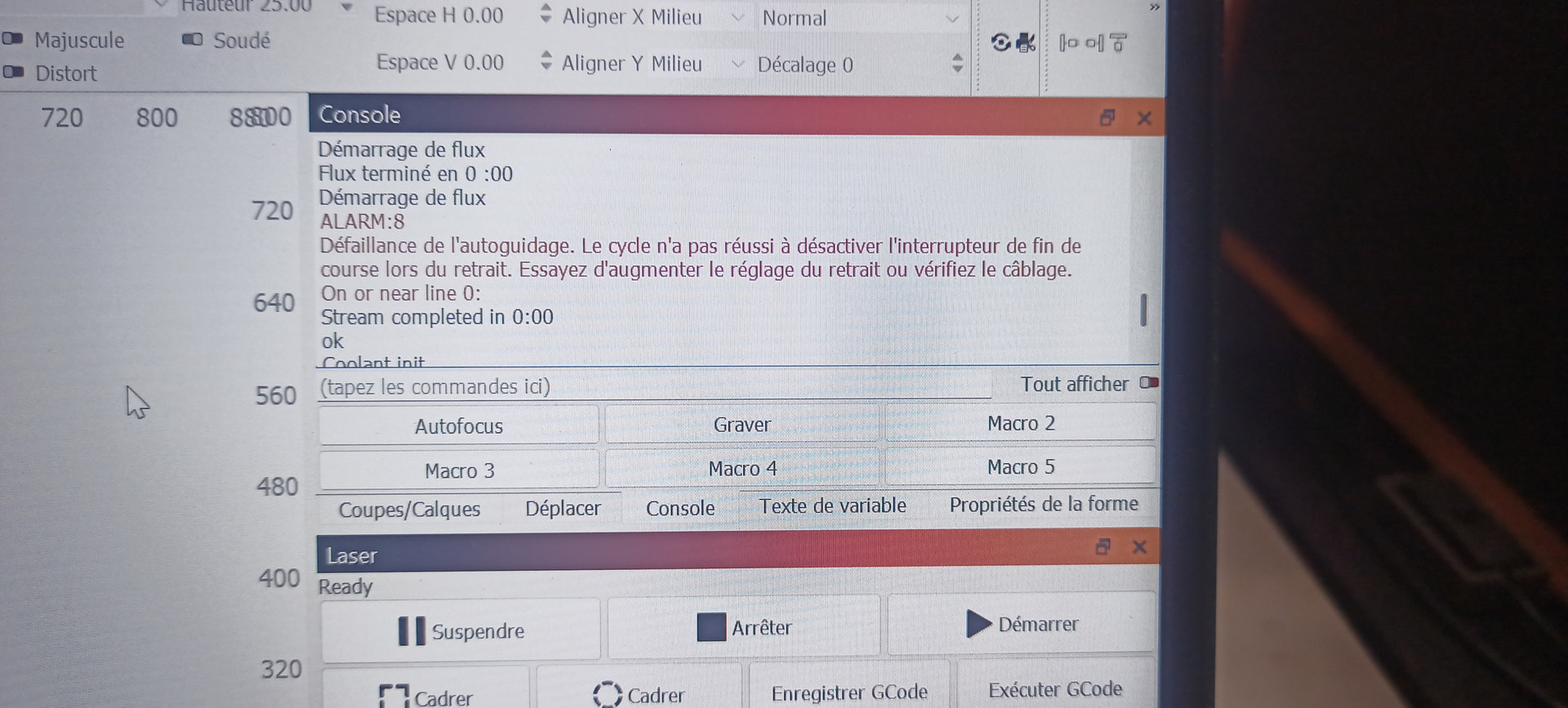

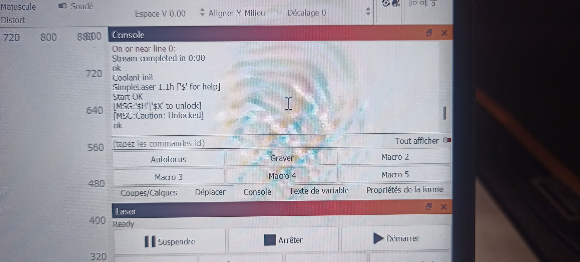

Hello, I’m giving up on FLUIDNC; I can’t get it to work. I’m going back to GRBL, where it works perfectly and simply. There’s just one last issue I can’t resolve: the Z-axis. It moves up and down normally, but when I try to home the cursor, I get an error message. It’s controlled by a simple switch connected with two wires. If you have any ideas, please let me know. Thanks in advance.
Here’s a link showing the model used for the Z-axis.
https://www.youtube.com/watch?v=HJ21jWowTmE

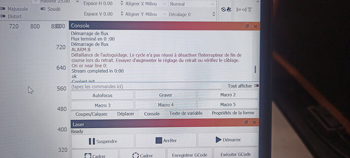

In the Console enter ? and record that result. Then enter ? again, but this time holding the switch closed with your fingers. Something like “Pn” should appear in the second line.
X and Y home
An idea just crossed my mind: should the switch be connected to the MKS DLC32 on Z or on PROBE? I connected it to Z (GND/IO34).
This shows your Zaxis switch is closed all the time. It must be on the controller Z input to see this, and indicates a fault condition.
Not sure what the “P“ also appears. It could be a cabinet door, fire sensor, or tilt switch. Or it could simply be normal.
For now, focus on getting that Zaxis switch working.
I just measured with an ohmmeter, at rest the current does not flow, when I press on the probe it flows.
