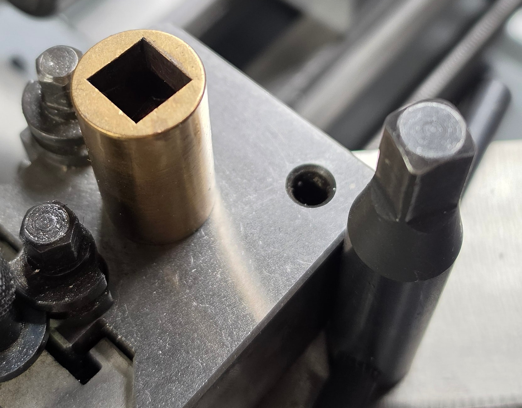

Here you go, one 10mm deep square hole “milled” into bronze for the retaining bolt for my lathe compound (one of the links above has the video on this).

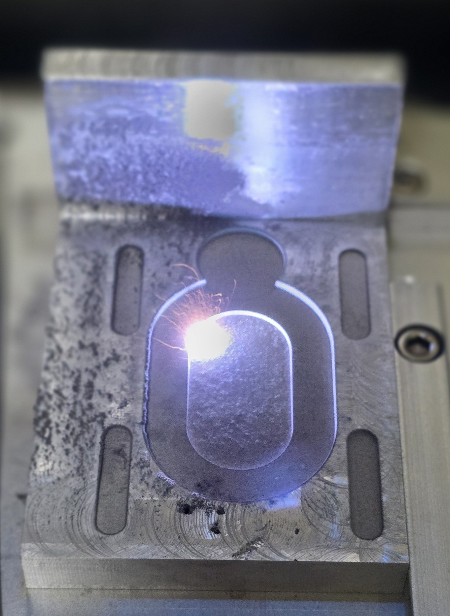

Here is another example where I was aske to make a two part mold in thick Stainless Steel flat bar. The engrave was over 3mm on each side and took over 30hrs for each side. While EzCad is clumsy and awkward, it does work for such work. Without Z-Control and supporting lots of layers by the time I’d dug down to the final few layers where the details are the edges would not be very perpendicular and the details would be lost.

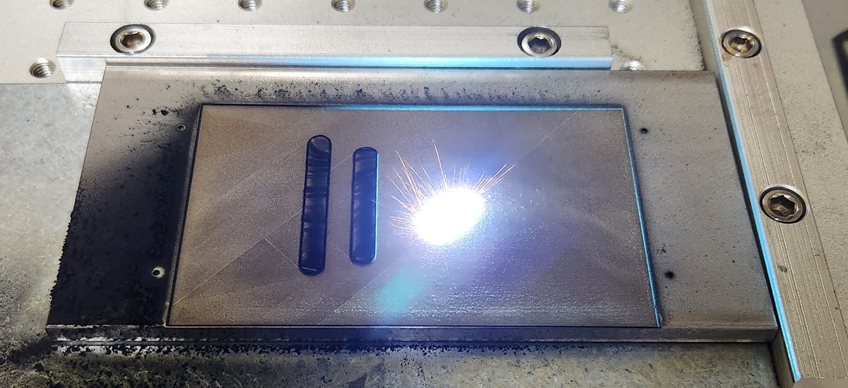

Its also great for all sort of layout and intricate milling, like this bracket. I designed it up as a 3D Model in Microsoft 3D Builder of all things, and used used the STL to mill it into the casting.
Note: These 2.5d lasers are not ideal for some of this work as you can not cut a vertical inside walls due to the beam angle, but if you just have outside walls and a good profile you are good to go.

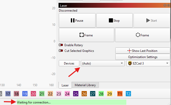

Hi team, I’m testing the 2.1.00 RC-6 release with a JCZ DLC2 board originally from an SLM 3D printer.
The board is not detected by “Find My Laser” and hangs on “Waiting for Connection” when added manually as an EZCAD3 device on both macOS and Windows. I’ve confirmed the drivers are correct, but the Hardware ID is:
USB\VID_9588&PID_9979
It seems this SLM-specific PID might need to be whitelisted for the new EZCAD3 driver to initiate the handshake. Is it possible to have this ID added to the supported list? Thanks!

On Windows, you’ll need to do the Legacy Zadig-Based Driver Swap.
“Find My Laser” doesn’t work for every machine, but in the case of a galvo, it only selects the correct device type anyway. The .cfg file still needs to be loaded manually.
Did you select the correct COM port?
Which exact JCZ board are you using?
We noticed a possible issue in parsing the .cor lens correction file.
Did you load the correct one for your lens when you added the device?
Please send a screenshot of “Laser Tools > Device Settings”.

I am using the JCZ DLC2-USB/ETH-2D-V3.2 board. I tested it first with the JCZ driver, then I used the Zadig driver. Yes I selected the correct COM port, during all tests it would just keep waiting for connection.
