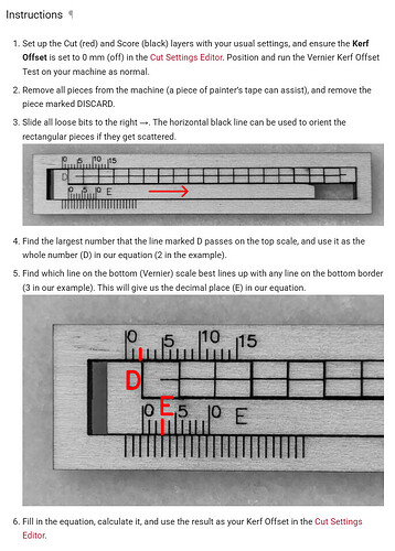

Do you use Kerf offset?
We have a new video out this week about using the Kerf Offset settings in LightBurn - do you use Kerf Offset in your work? How has it worked for you?
The new Kerf Offset calibration tool can be found here: Kerf — What It Is and How to Compensate for It - LightBurn Documentation
I don’t know if it’s necessary to add in the documentation that with an activated kerf setting, “remove overlapping lines” in the cutoptimization settings will no longer work. The reason for that can be clearly seen in the preview window. (LightBurn does not “compensate” for this offset in the remove overlapping function, otherwise it would be nice if it were possible)
Yeah, add it to the docs. That is a pretty important detail. :nerd_face:
