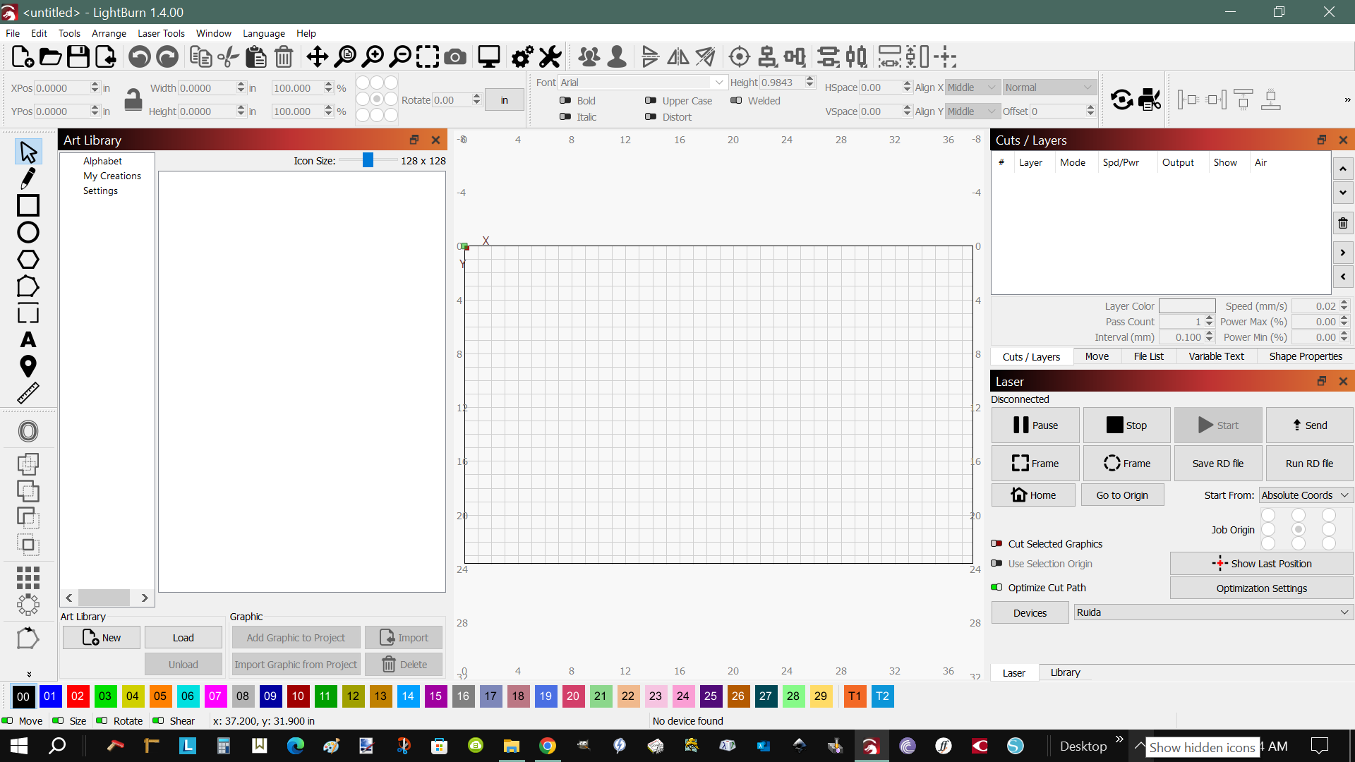

This is the opening screen even after successfully docking the Art Library toolbox.

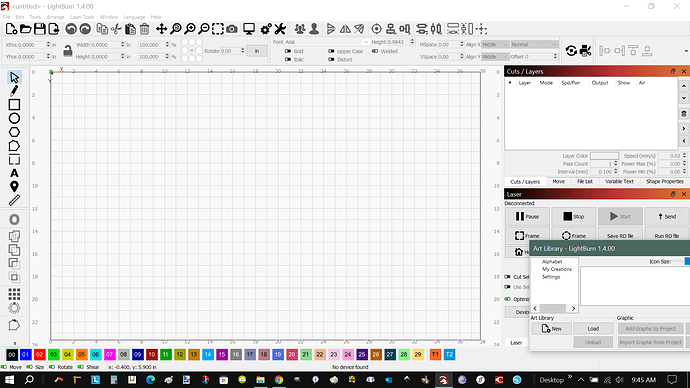

After shrinikg the Art Library, then dragging it over onto the right pane it still would not dock.

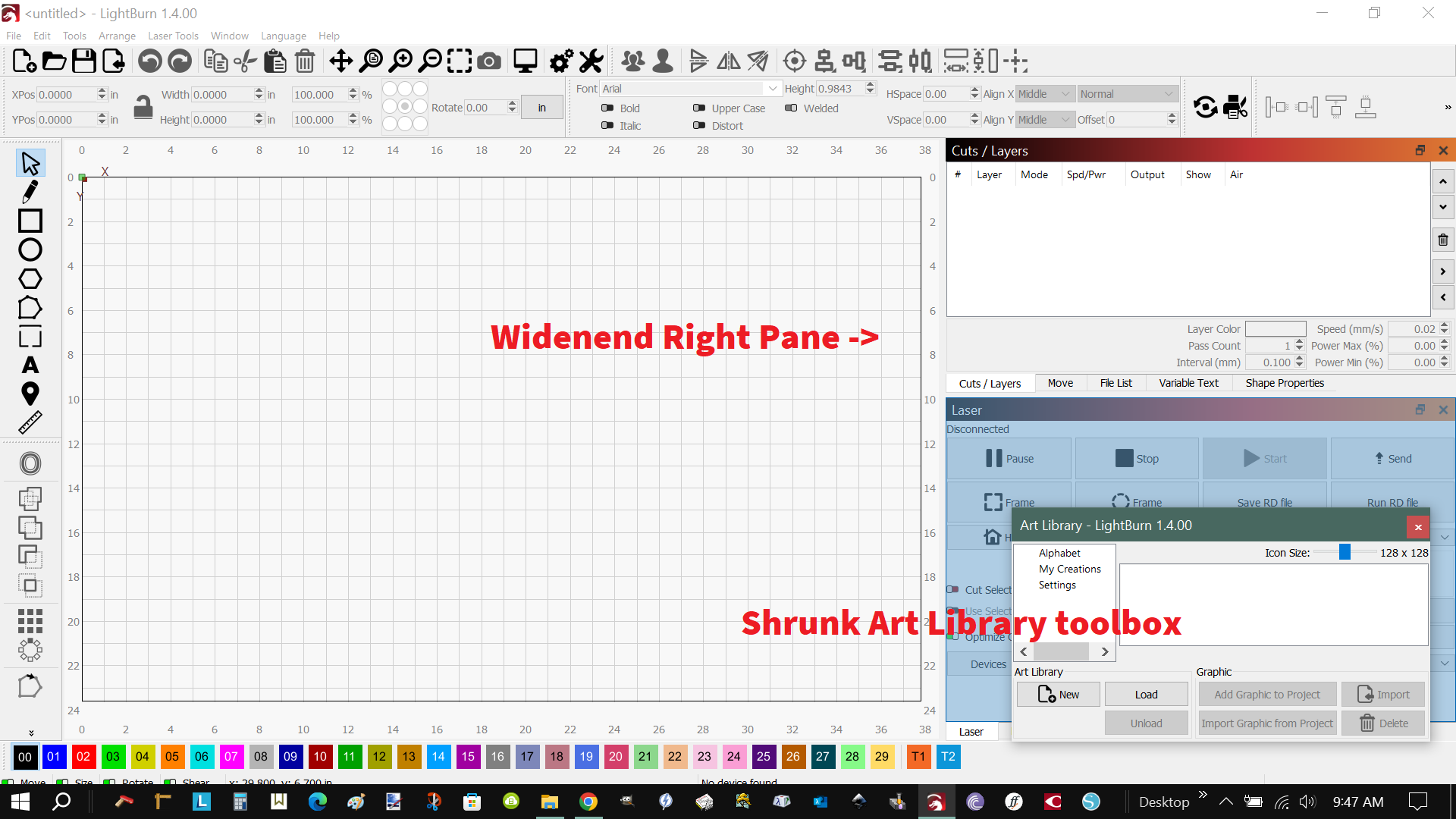

Widenend the right pane and successfully docked the Art Library. Pic is before releasing the left mouse button.

Art Library reverted to previous state, i.e., undocked and appeared just left of the left pane as before.
I believe that’s the default location for Art Library window so not surprised by the location.
I tried to reproduce this. Made the right pane as narrow as it would go but didn’t have a problem getting the docking to behave. Worked the same as widening the pane. One note is that it’s the location of the mouse cursor on the titlebar that’s relevant for docking behavior. You seem to have no issue with docking in other cases so likely not an issue but just check for it.

I assume you mean docked here? This is also different than what I see so wonder if that’s a clue. When restarting LightBurn the Art Library window is retained to whatever state and location it was prior to closing.

It is in fact docked, but on the left side of the workspace. When I said “undocked” I meant not landing as docked in the lower right portion of the application, just next to the Library, etc.
