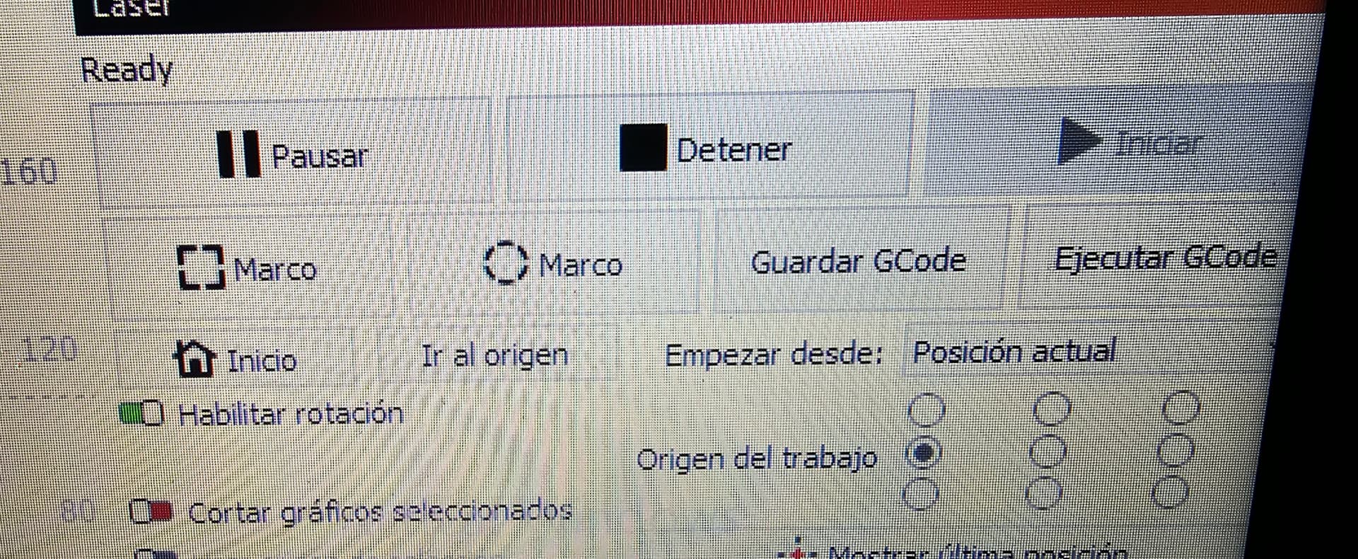

I come to you because I’m desperate because I don’t know what I could be doing wrong.
When I engrave glasses, the medium does not respect me.
I try to record it in the middle taking into account the logo of the glass, however, it always records more to the right.
Please if you can give me a hand and tell me where my mistake could be.
I attach a photo where you can see that it records more to the right than it should.
Beforehand thank you very much.
Any help please?
What do you have for values in Start from and Job origin in the laser window?
I’m not tops with grbl, but I use rotaries quite a bit…
I use actual position my friend.
