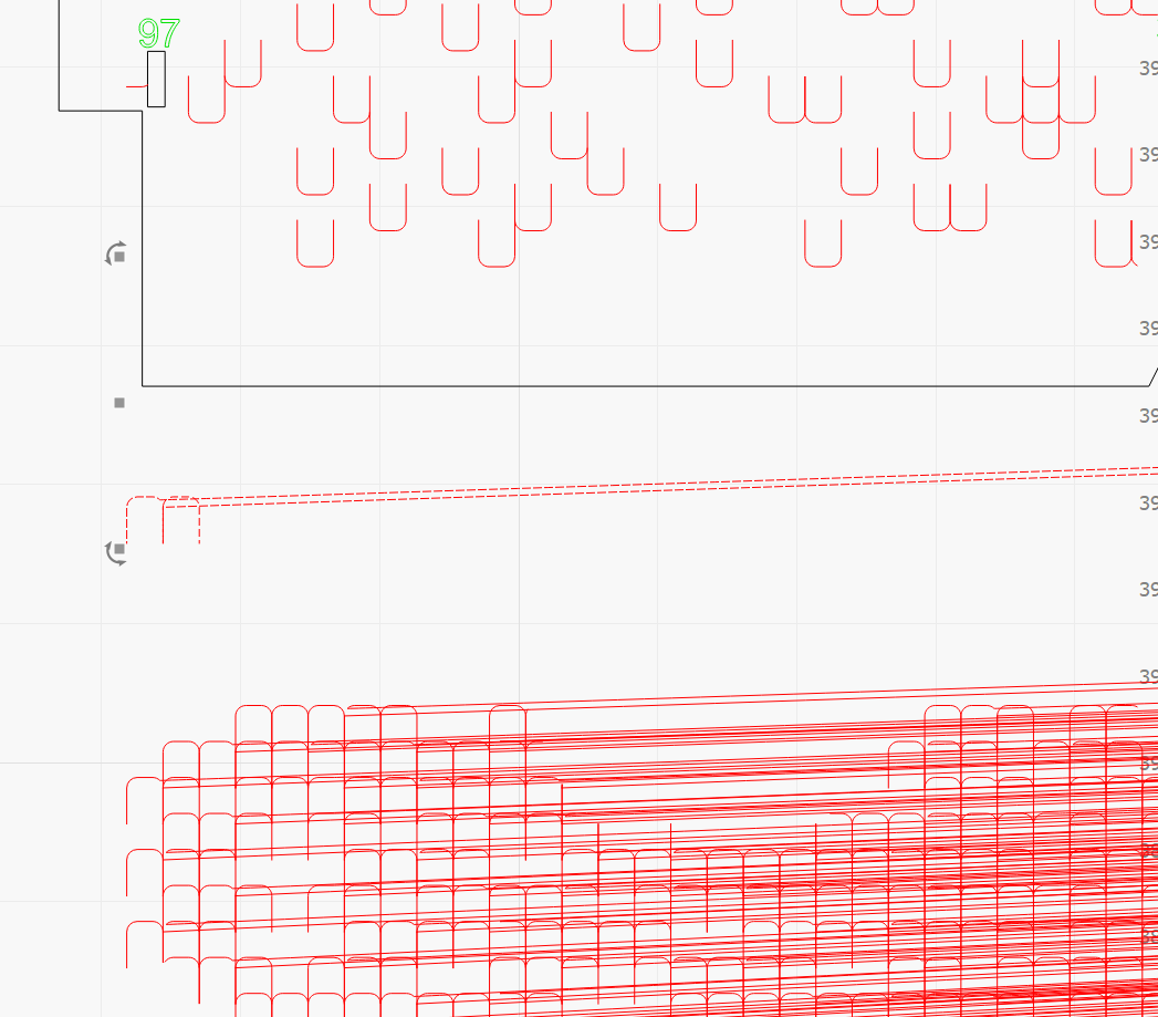

I have a file for a dollhouse roof that has a pattern on it for roofing tiles. Lightburn shows the pattern in red, but it covered up almost completely in red by horizontal lines very close together. I see the roof correctly in Vectric Aspire 11 but not in Lightburn. Any ideas how to fix this is appreciated. I am very new to this and trying to learn Lightburn. Thanks.

It is not in the preview window. I turned transversal moves off but it shows up in the static screen as soon as the file is loaded. It is also there in the preview screen with transversal off.

The first 2 are what shows in Lightburn. The 3rd is correct in Aspire.
I’m not sure exactly what’s going on there but there seems to be a general rendering issue going on. Notice the corruption in the screen where you have part of the UI being drawn through the tabs.

Here is the file. Since it works in Aspire without any red streaks, it isn’t the graphics card. Hopefully someone can reproduce the problem on their computer so I will know it isn’t my computer doing this. As I stated, it is only doing this bon the roof. I wonder if it can be orientation in the x and y?
Definitely not a graphics driver issue after seeing it. Seems like some sort of importation issue or a DXF issue.
Looks like one part of the tile is located completely in a different place so is creating the long line. This is repeated for hundreds of tiles.
How are you generating the DXF? Do you have any other format options? Or different versions of DXF?
@RalphU Do you think the auto-close tolerance value could affect the location of the errant nodes? I don’t work with DXF frequently enough. My understanding was that even with this setting “wrong” you could potentially have paths left unclosed but nodes would otherwise be located where expected.
At first I didn’t see how this could cause the problem but I think what’s happening is that because of the proximity of the tiles, LightBurn is interpreting some of the lines as continuous sections and then connecting them in an incorrect way. Rinse and repeat hundreds of times and the effect here is seen.
This may be an inherently difficult issue to solve for while using DXF. It seems LightBurn is using the tolerance value to auto-join line segments, not just for closing paths. Does this mean that importing with a tolerance set to 0 would leave “curved” lines as disjointed sections?

In either case I think avoiding DXF entirely might be better. Looks like Vectric Aspire can export to AI format. Assuming they preserve curves in the AI export this would probably be preferable to DXF in this case.
This morning I tried opening the file in Aspire and exporting as an AI file. Opened Lightburn and imported it in. It worked perfectly. The problem I have in Lightburn now is the file is way bigger than the area on the screen. How do I get this to fit? Thanks for all the previous suggestions.
