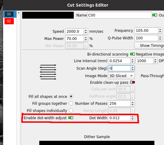

New to Lightburn. I understand the idea of DWA. I saw the video. How or where do I find that in the software?
Thanks
Doug
It’s under Cut settings when you have an Image layer.
