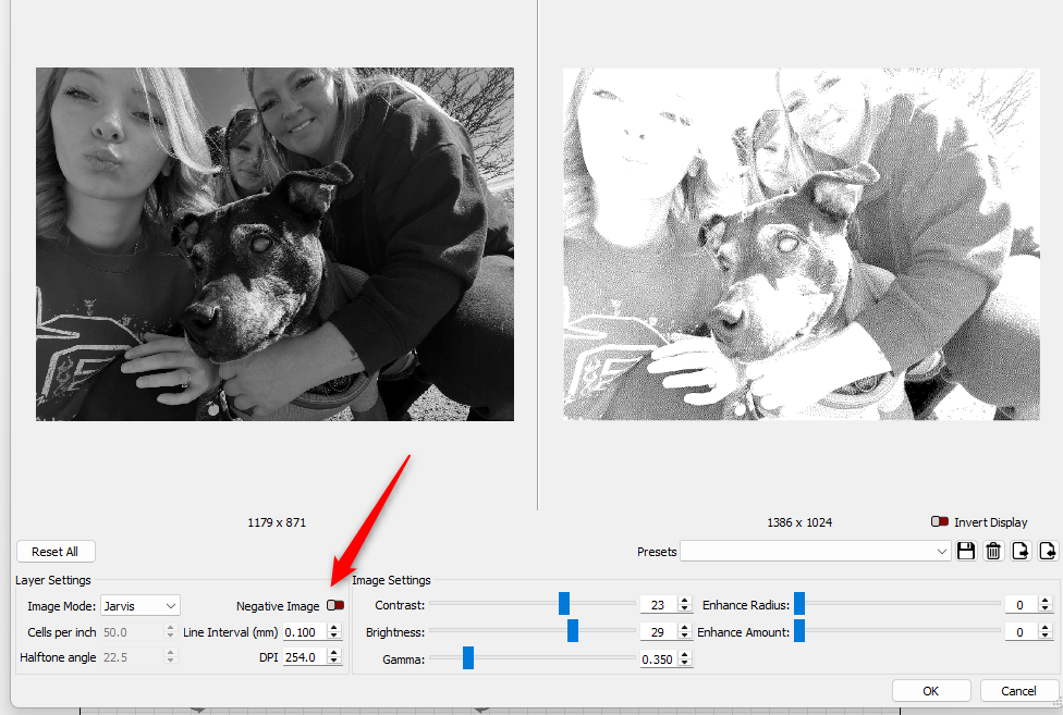

Hello, When I engrave pictures it does them with a bunch of dots instead of lines. the link is the example is this normal? https://drive.google.com/file/d/18Qg5xK8bZkN_67LOEOdOQiYUU5T_CMyR/view?usp=sharing
It depends on your choice for this layer.
…same image, two different settings

These are the properties I am referring to. For example line spacing or type of image rendering.

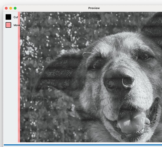

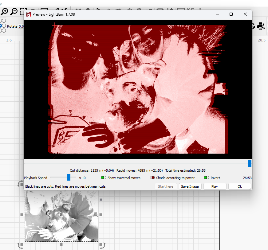

I dont know what I did all of the previews are in negative mode and I cant figure out how to get it back to normal, I turned it on once and now it wont turn off,
I started a new project and still the preview is in negative mode
In the preview window uncheck invert
Wow thank you so much I was getting very frustrated

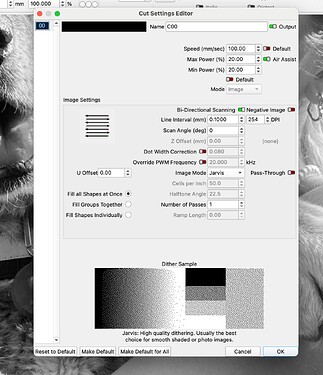

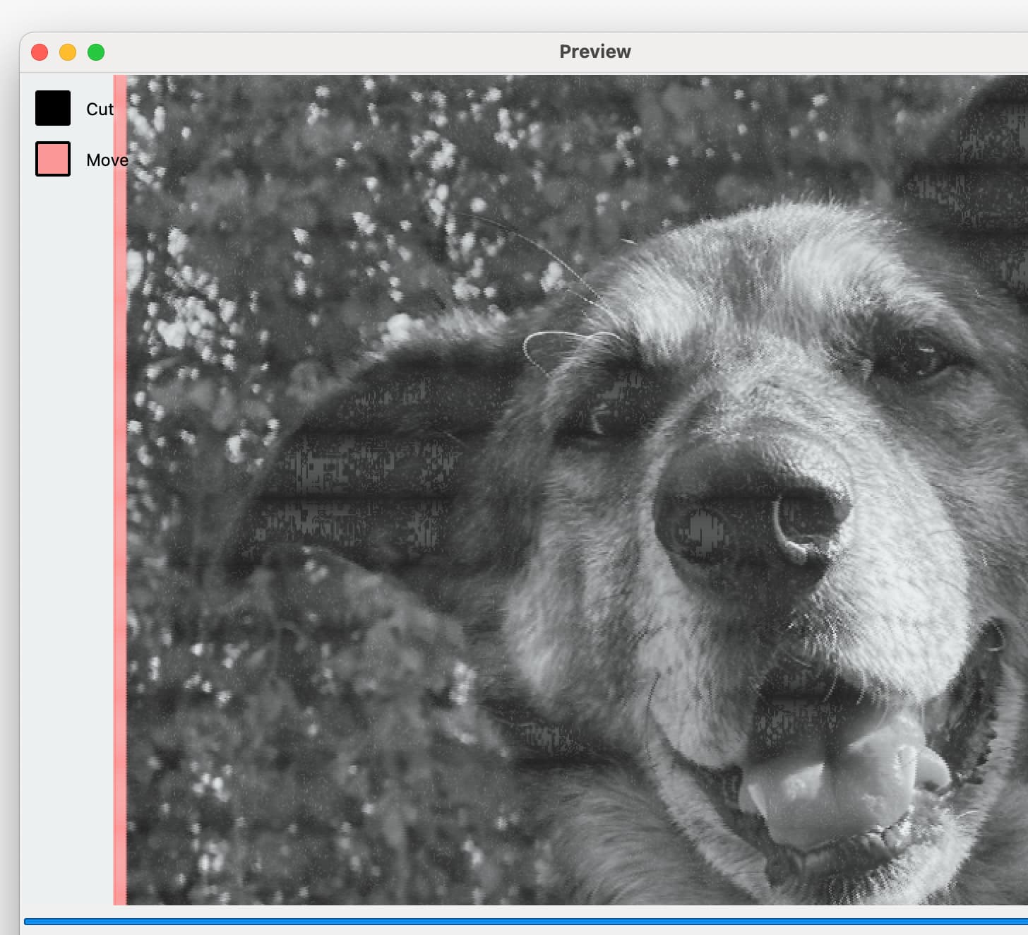

Yeah I read all the documents and just watch 3 videos and I still cant get my picture to look like yours I don’t know what I’m doing wrong, I can not get my pictures to look like yours in your screenshot. I only have 1 layer and I’ve spent 10hrs trying to figure this out, I just need some help
Images are the most challenging thing you can do with a laser. Not only does the material you are burning make a difference, but the image itself is also a factor.
  1. Image modes, including pass-thru.
  2. Image brightness, contrast, gamma, and color.
  3. Material you are burning.
  4. Whether or not the material has a coating, like paint.
As you can see, there are a lot of variables. Expect a lot of testing and a fair share of just-not-rights during your work.
If you accept all this, and take good notes while testing, you will find it less exasperating to work with images Here is a video that gets suggested a lot:
Show us your settings and/or post your picture here and we can give it a try.
