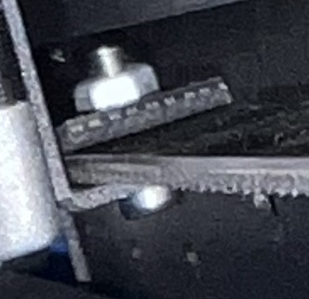

Yes, although the screws on yours are arranged perpendicular to the idler axis, so they cannot possibly adjust the belt tracking. This may be one of those inexplicable screwups common to cheap lasers.
Which means you have probably done as much as you can to compensate for the problem, with no change to the results.
If you’ve also verified the belts are not touching anything and the gantry moves smoothly by hand (with the power off), then I admit to being out of clever ideas. Heck, at this point I don’t even have any dumb ideas.
Installing new belts should be reasonably cheap and easy, so it’s worth trying. Best case: while you’re going through all that hassle, you’ll spot something obvious we’ve all overlooked.

Only think I came up with is that the belts might be poorly installed.

What is going on or what am I looking at with image IMG_8186? Looks like it’s covered with some type of dust… is it wearing somewhere?
I ordered 10mm width belt with 2 mm pitch, new pulley will be 20 teeth but smaller than current one (inner diameter is same), so it should fit.
It feels like metal sawdust, could happened when I was manipulating with pulleys etc, since some parts and side of the machine is little scratched.
With the issues you are having along with the problem of finding the culprit, I’d suggest you determine for sure where and why you have this occurring.
A pile of metal dust/shavings is not an expected operation unless you running a saw or abrasive operation of some type.
Im sure its from manipulating with frame since some scratches are on the right inside of the machine. Also when I was tightening some screws some paint came off from them. However it should be all cleaned now.
I tried to disassemble the machine yesterday to prepare for new pulleys and belts.
I noticed that movement of one of the linear sliding blocks is shaky (vibrations), like there are some bumps on the rail.
I swapped them and figured out the problem is not in rail but in one of the blocks since it was doing the same think on the other rail.
Could this be the problem?
Might solve out why it is dotting on low speeds but when I increase the speed (25mm/s and more) the dots disappear. Only problem on high speeds are wavy lines.
Still dont know why the problem would be so periodical like on this picture.
Hi!
Just wanted to share that I managed to solve the problem.
After I swapped old belts and pulleys on y axis with the new ones (10mm width instead of 15mm, pulley has 2 mm tooth pitch) the results are rapidly better.
I think that if I would swap linear blocks for the new ones the result would be even better (right side block is going smooth but left side block seems bumpy) but no need since the results now are acceptable for work I need to do.
