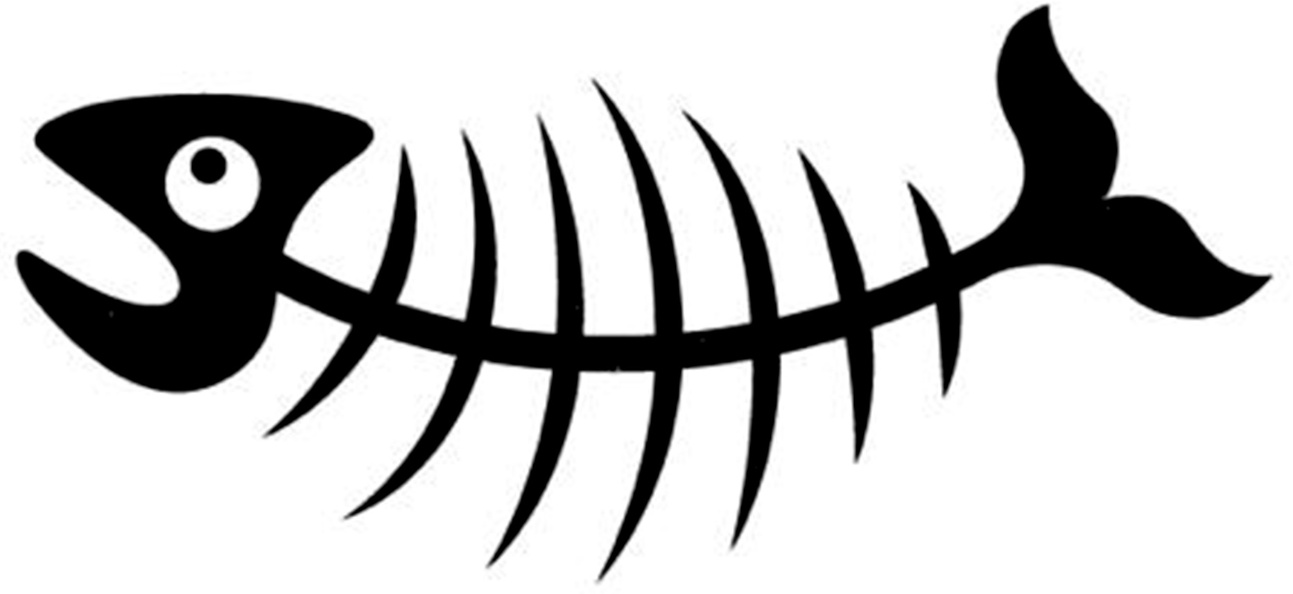

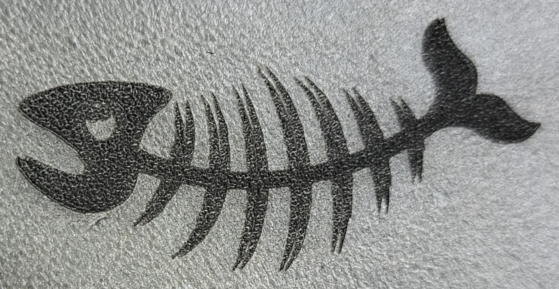

I have a Creality CR Falcon 10W Pro with air assist. I use it with Lightburn software. Initially it worked fine, but lately it has been engraving double/ghost images. I have checked all the mechanics - it stands on a level work surface, I’ve cleaned all the tracks and lubricated the wheels. Do you have any advice for me please? I have an urgent job that I need to complete and I really need to solve this issue. I’m not fully clued up with Lightburn software yet, as my previous small engraver was super simple. Would really appreciate any advice

Is your ghosting in both the x and y – or just one axis?
G
Seems to only be on the x axis..
Show a picture of the results.
Check the lens, do the wall test to check how the beam looks like (point it to a wall and take a picture).
Here is the image i tried to engrave and the result.

I have found it is often the beam hitting the edge of the hole in the ‘cone’ the air assist [and beam] come out of. I made a tool that Russ from RDworkslearninglab-youtube adopted- high praise IMHO. Gene
