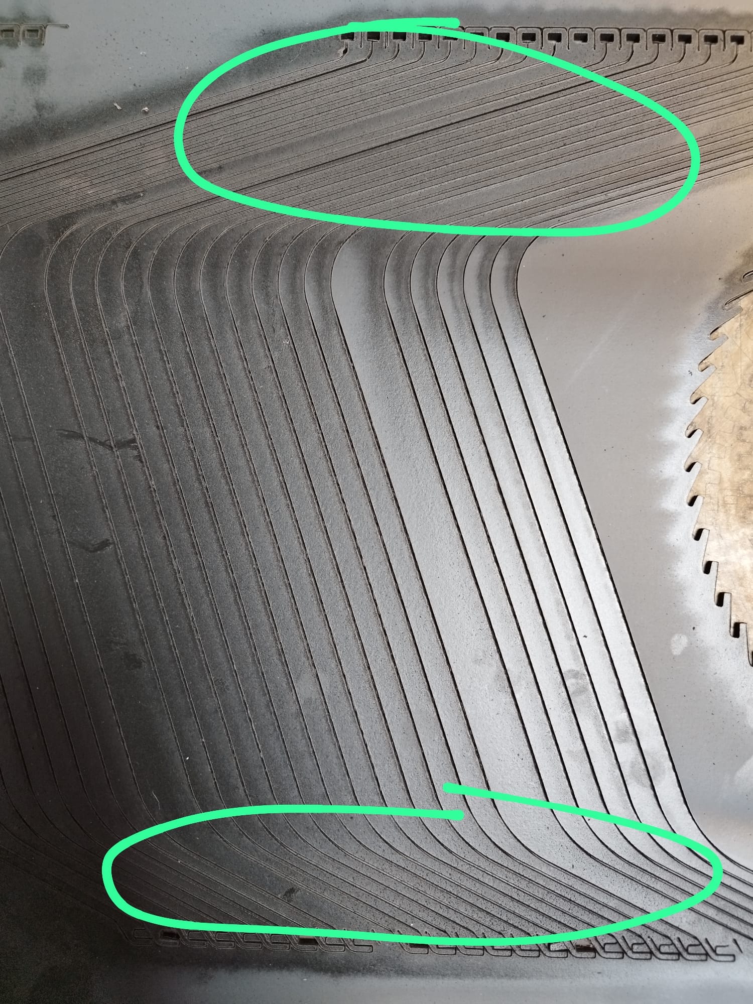

Hello everyone, I am having a double-line issue. I have already adjusted both axis, but the problem persists.-
What i find strange is that all the double lines go in the same way, and they al seem perfectly cut and seems like a pattern and not linke an error.
Any advises? Is it a harware issue?
Thank you all in advance.
To me it looks like you may be missing steps on the X-axis. Check belt tension and make sure you’re not skipping the belt. Also check that the pinion gear is properly secured to the stepper shaft.
I adjusted both x axis nuts and y axis nuts. Also tightened the belts´ tensions.
I will check on the pinion gear.
Thanks for the advice. Will let you know.
