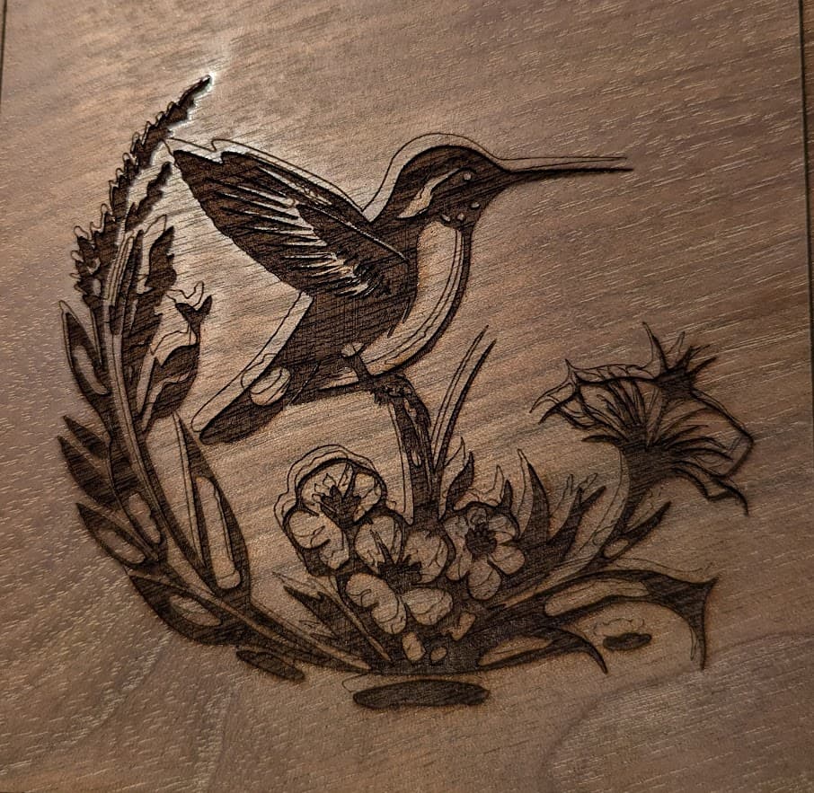

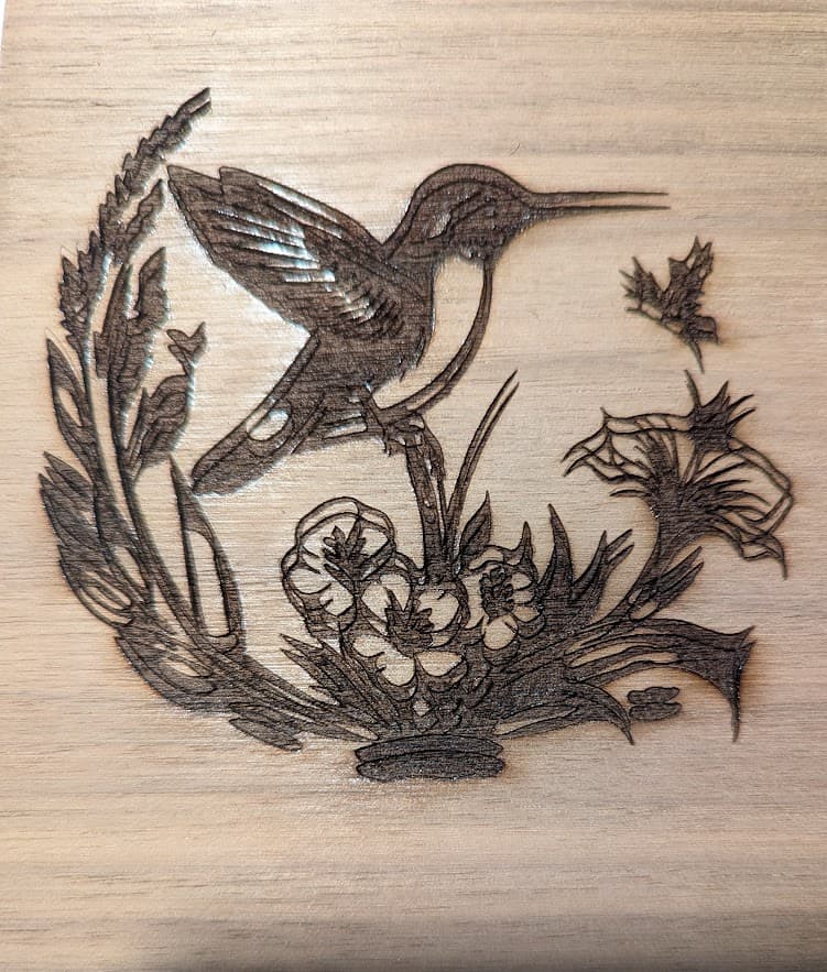

I’m running version 1.7.08
I did a flood fill with a cross hatch / line after fill / 2 passes.
Speed 3000/33% power, Ortur 20 w diode laser
I’m getting double lines
This has happened before due to the piece moving while the laser was operating but that’s not the case this time.

Does the shift occur when you use regular fill?
If the Preview window shows the layers aligned correctly, this is most likely a mechanical issue.

The preview is perfect so there must be movement some where,again!
This guide is an excellent resource for ruling out mechanical issues:
Does the shift occur when you use regular fill instead of flood fill?

I found my problem!
A friend shares our small shop with me and apparently he needed more height on the laser for a project he did. He put the laser up on 1/2" Baltic Birch plywood blocks so the frame was not secured down like it was supposed to be. I had the laser speed at 3000 and some of the moves are fairly “jerky” and I’m almost positive that was my problem and caused the double lines. I haven’t had time to check things out yet buy will soon.
Thanks again for your help.
