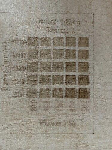

I have a laser but this morning it seems to be double printing Does anyone have suggestions or videos that might help
Thanks for the help
Thanks for the help
Hi Angelica,
On Diode Lasers, 9 in 10 times ghosting is based on X axis Belt being loose.

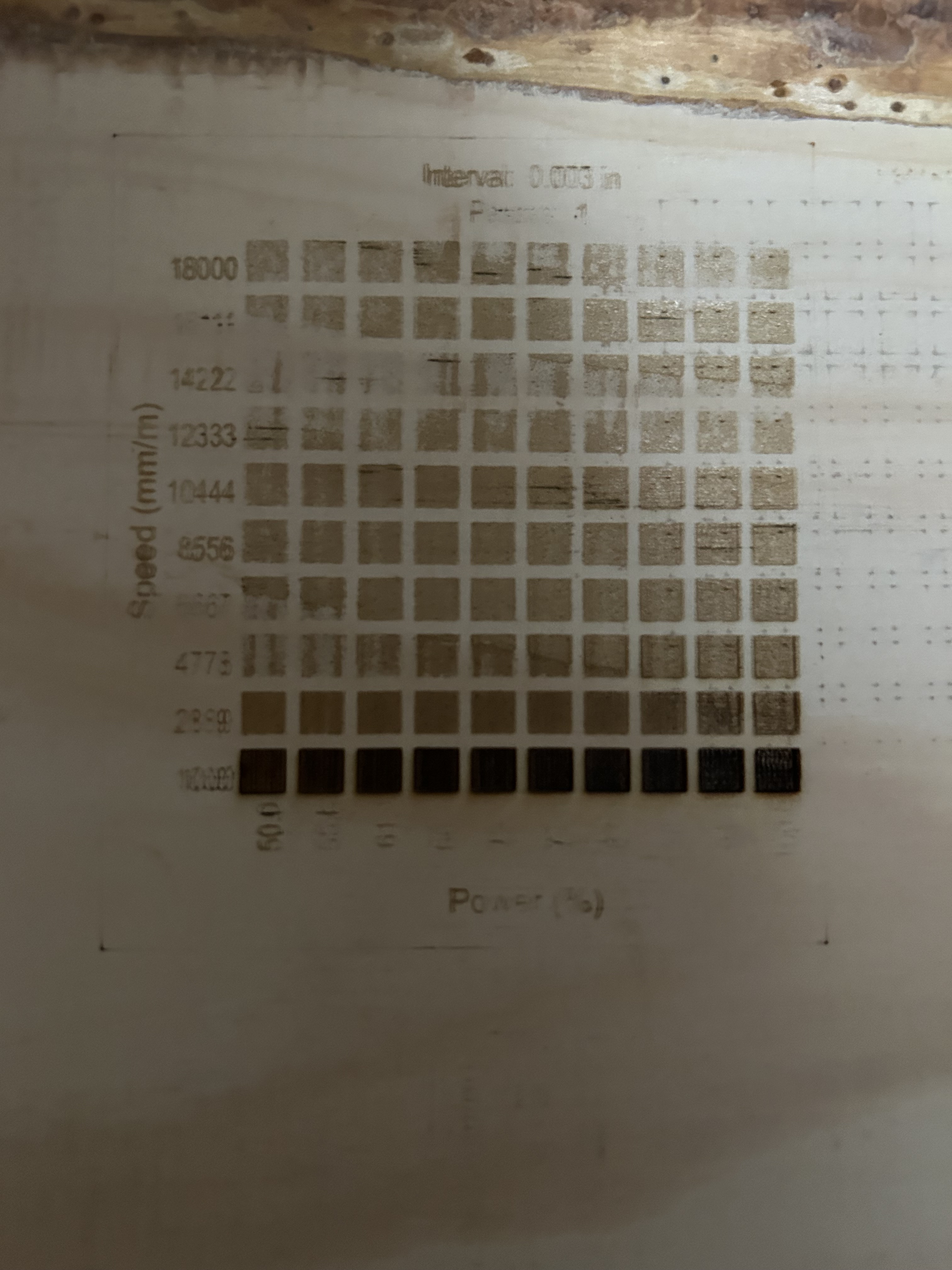

Review your belts , tighten them a bit and then run this test file and take a picture to show us please?
Dot Test with Angle.lbrn (46.3 KB)
Thanks I’ll try
Your X belts still need tightening
As per attachement - right click link > Save Link as > Save to desktop
Then open
