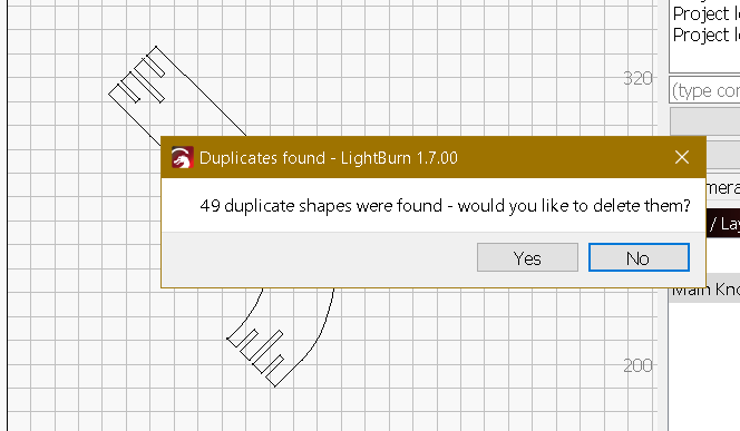

Double Trouble - Selecting a single duplicate after ungrouping
The way it is designed you have to brake it apart and then click select.
Just a few…
And if you brake it apart you found 49 duplicates .
How to you seperate the upper and lower copies?
No way to break it apar without editing the whole shape, which is what I had to do.

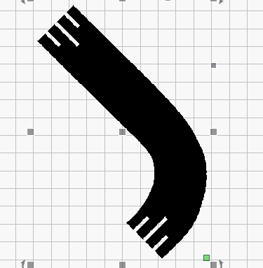

My steps:
    1. Select shape
    1. Alt + B (Break apart)
    1. Alt + D (Delete duplicates) (49 OK)
    1. Alt + J (Auto-join shapes)
    1. Cut/layer set to Fill
    1. Shape still open so Edit > Close Path.
Fantastic!!! I have never used the break apart command! I could have saved hours of manual editing! Thank you for a very important lesson!
