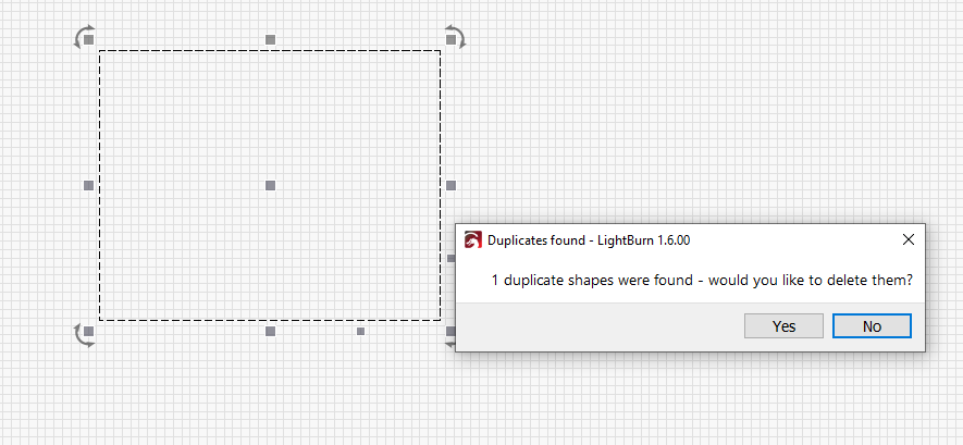

Have you tried edit> delete duplicates?
Menus - LightBurn Documentation (lightburnsoftware.com)
Thwonk!! Sound of forehead hitting desk! I could have saved 2 hours or more this afternoon! Thank you!!!

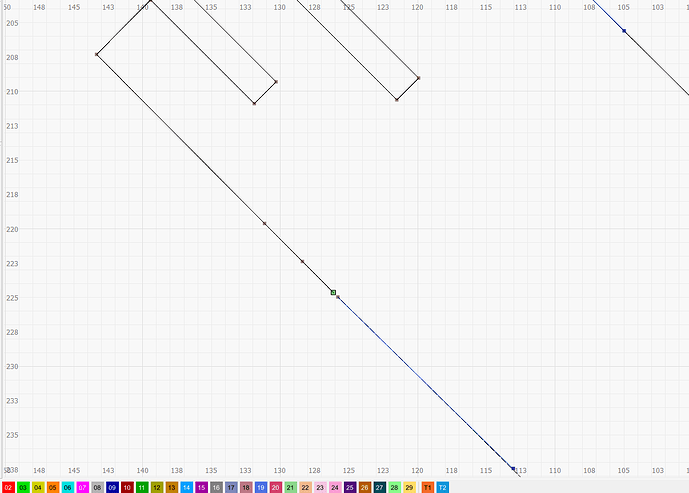

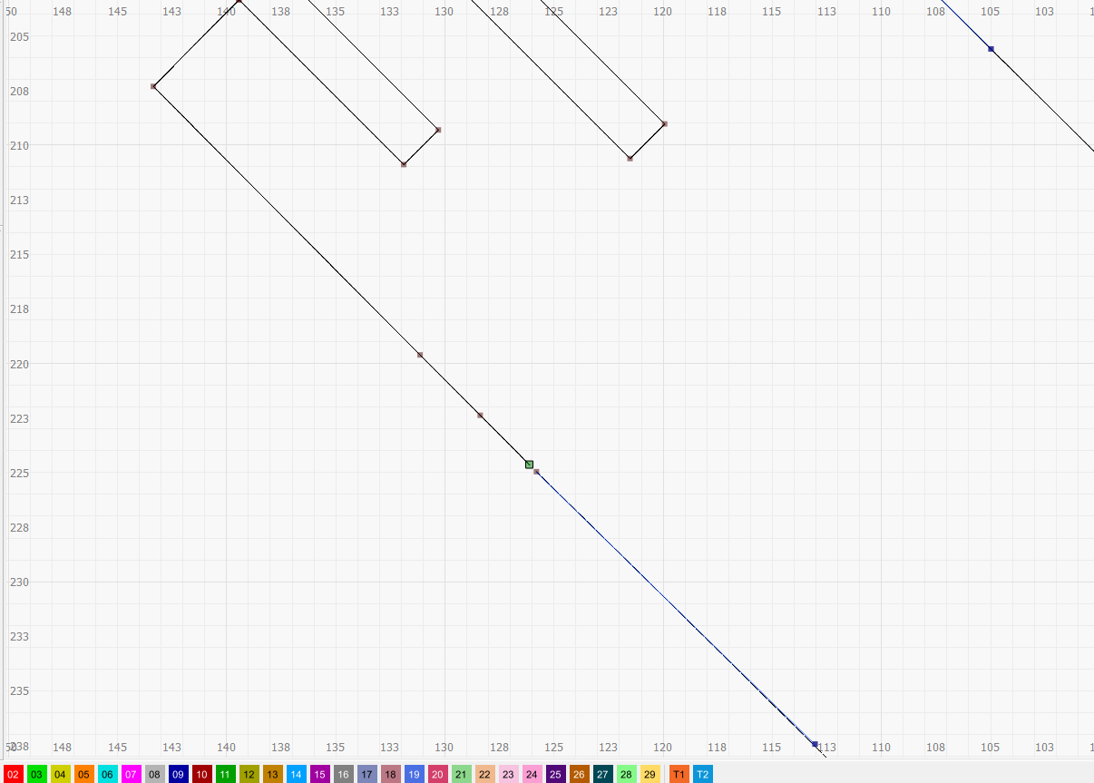

Here is one of your problem areas. The shape is not closed here, but it won’t allow it to close either.
I looked further and you have lines on top of each other. I hade to break the nodes apart to prove it, but you can see here where I moved them apart there are multple lines in the same space. The easiest thing would probably be to redraw it rather than trying to manually find all the errors.

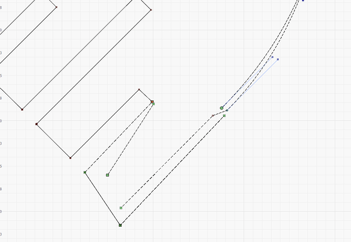

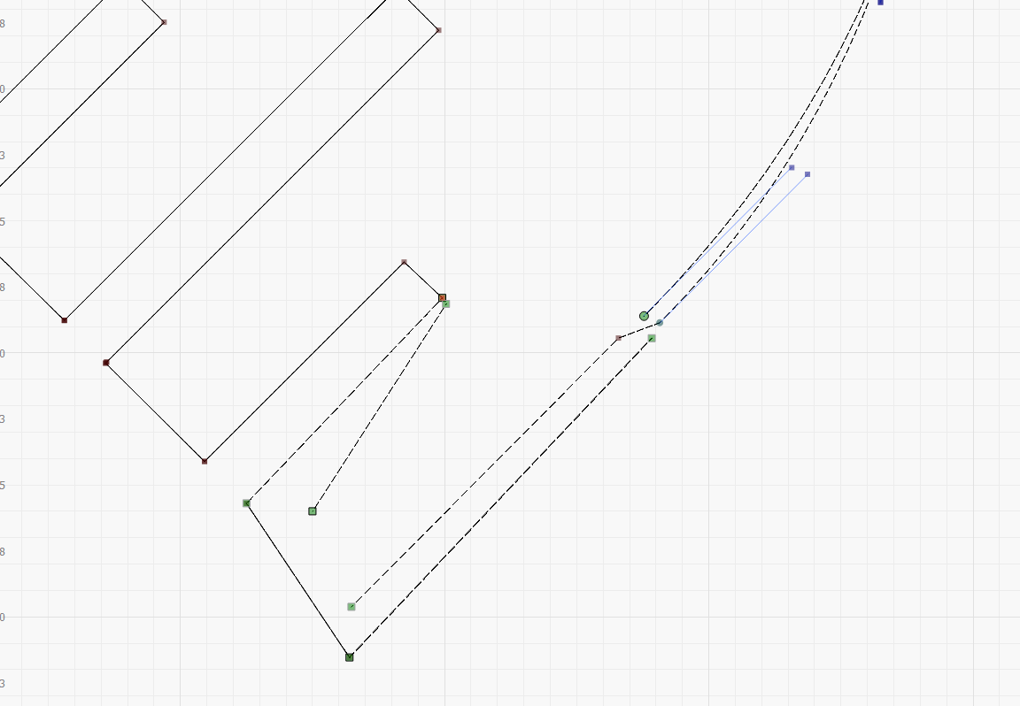

Using the node editor, I DO see multiple lines in the same place, but it’s still a single unit. Edit, Delete Duplicates finds no dups. But I do see several lines, joined at nodes.
How did you craft this part? Did you have Edit, Auto-Join Selected Shapes turned on? It appears to have multiple lines joined at at least two nodes.
I created the element, in Photoshop, then saved as an ai in Illustrator and imported. I thin decided to clean up the graphic and I recreated parts of it in Lightburn. There are 5 or 6 elements that are repeated in a Celtic knot design. I was in line mode, using the node editor. When I was done, I replicated all the elements one by one and replaced the originals with the new duplicate. When I though I was ready to burn, I switched to fill mode and it coughed up blood! I am creating an embossing plate in 3mm lucite, and this element is the deepest of the rest.
Ideas?
Bob
