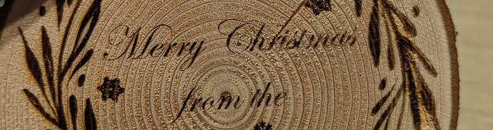

I have a Sculpfun S9 and have had no issues with this until about a month ago. I use LightBurn 1.4.04. This is a somewhat “old” issue as it keeps happening. I will somehow “fix” it but then yet again it will pop up. My problem is I get this letter doubling/light engraving on the Right side of my engraving. It can be lighter too while the left side shows up very prominent. Here are some examples below.

Are you using level pieces of wood? Or rather pieces of wood that are flat and the same.thickness all the way? I notice theyre pucks of tree branches. To me it seems like part or your work is closer to the lens and part of it is further away. Is your laser slipping on the Z? Have you checked your lightburn file for overlapping / cloned lines to see if it may be causing?
Hey thanks for the quick reply! Yeah, I have tried quite a bit of different materials. And they are pretty simple patterns. Is there other overlapping/cloned lines that I should be worried about? I’m decently new to LightBurn and engraving so it really could be something simple??
Hard to compare the results between Lasergrbl and Lightburn. The settings are completely different and so is the wood.
The “doubled letters” on the third example just looks like smoke staining to me. Should wash off. I use alcohol. That will also lighten the engraving itself, tho. Many people cover the face of the material with painters tape or masking tape and engrave right thru it, then peel the tape after to reveal a pristine surface. The stripes or banding on the snowflake concern me more. It’s kind of a mish-mash of anomalies.
The first example is hard to make out enough detail to make any meaningful suggestions.
The second example looks pretty good but I think I see some serrated edges to the wreath that may indicate some scanning offset tuning would be a benefit.
Hmm not bad ideas, I will look into the offset adjustment more!! The biggest thing is it affects the right side more than the left. Can you see that on the third picture/snowflake? It’s fuzzy on the one side but the left side is pretty clear. Same with the second photo wreath (and if you really really look ‘chri’ looks good while ‘mas’ is doubled. And same with the first photo too, while I agree it’s tough to really see what’s going on there without context.
