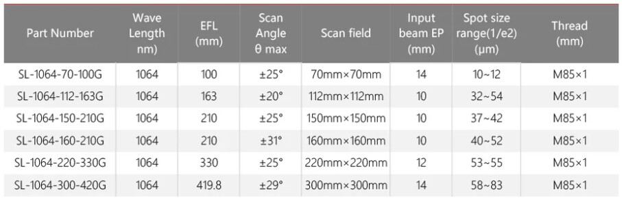

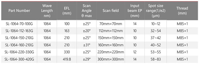

Lenses for fiber machine, IMHO, be specified in focal length. Lens types for galvo machines are designate F for flat focus. Focal length effects coverage, but they are not the same. Note an F210mm lens could cover 150x150mm or 160x160mm depending on the scan angle. I think this graphic was from Cloudray.
