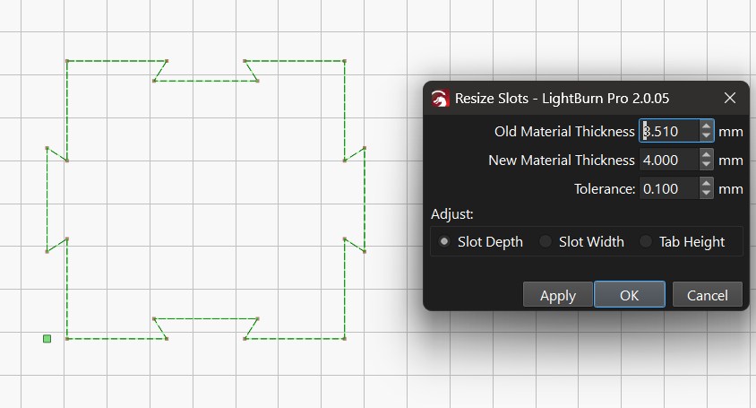

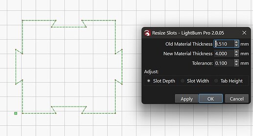

Dovetails Resize
It looks like Dovetail can’t be adjusted in LB’s Resize Slots
Dovetail Test.lbrn2 (6.1 KB)
Oh Well
Yes, that’s true. The function is not trivial to implement, and it only looks for 90° corners. Dovetail will not work.
