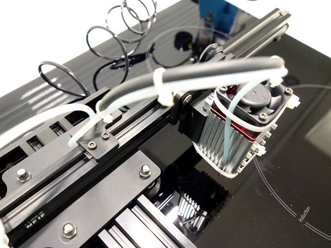

couldn’t wait for the printed part for air assist, and i’ve gone the full macguyver as an interim measure
it does surprisingly well given the air flow is quite restricted by the current connection i have had to fashion, but hey ! it works, although i think the non-lite ply will be much better off with more vigorous nozzle pressure
anyway, pics worth 1k words below with brief captions
the works - self explanatory really
the compressor to gantry connection - the chokepoint for air flow currently, but still manages an audible hiss at the outlet
tethering and distal supports
the business end - silicon fuel tubing (from stock for a 0.5cc diesel from my youth, and a 1/8" brass tube with bespoke bend, rammed in the end; the zip ties seem quite adequate for the task
