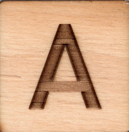

The reason for it is as the laser slows down for turns, you usually want the power reduced along with that so they don’t end up torched. For example, if you engraved without overscanning enabled and used constant power mode, it would look like this:
..because the laser slows down to turn around at the edges, and if the power isn’t reduced to match, you get the above.
The problem you’re having is related, except that you asked the laser to go really fast and it couldn’t, so it reduced the power to give you the same level of burn you technically asked for.
