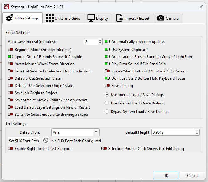

We are making suggestions on no provided screen snapshot (SHFT+WinKey+S) of your settings.

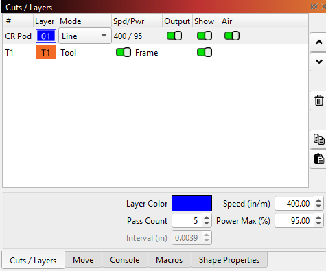

Using v2.1.01, please capture the Device Settings window and the Cuts/Layers window. Upload them in the Reply window.
Almost nothing has changed between 2.1 and 2.1.01. If you can provide a screen shot of your settings, we can point you at the issue most likely.
And you should mention what kind of laser - your profile says 3018 - is that still the case? Those are pretty slow, so if you entered a mm speed in inches the machine would hit max speed, and would lower the power output when it couldn’t reach the speed you asked it for.

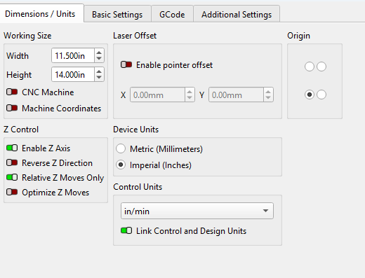

Here is the setting screen shots. It’s moving fine, the laser is not coming up to full power. I’ve tested the laser in other apps and it come to 100%.

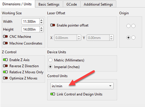

It looks like you need to change your device Control Units from ‘in/min’ to ‘mm/min’:
How does that affect the Laser coming to full power? but I’ll try it. Thanks
If you are using M4 laser mode the power is automatically lowered if the speed gets too low.
So if your job is set very fast at 400in/min and the machine can only physically manage a much smaller value the automatic power lowering will activate since it’s scaling the power based on the speed range.
No, that did not work. Laser still remaining at minimal power, it comes on but must be near 0%. Lightburn has been extremally reliable up to now. I’ve done a lot of stuff for church, scouts, school and the rocket club.

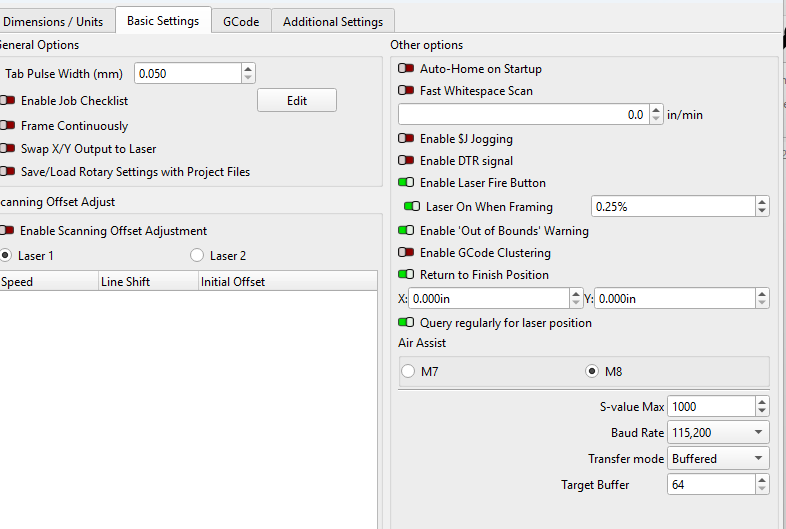

That’s where I’ve always ran it and its worked beautifully. Should I have different M setting?

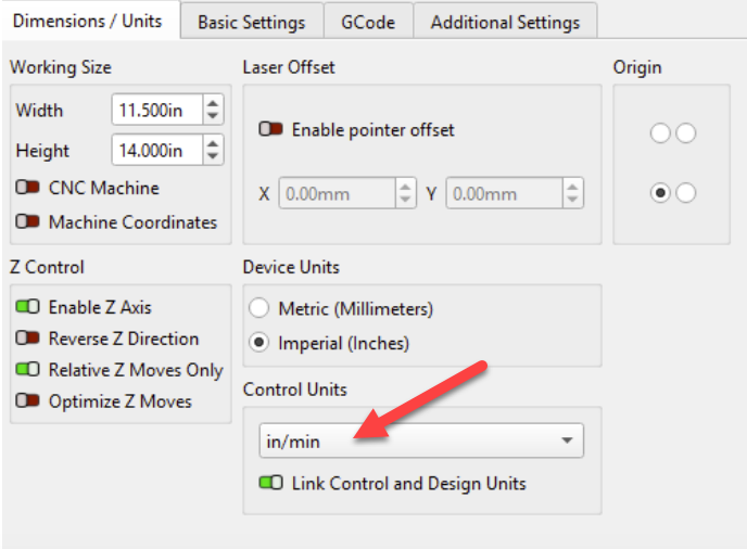

Hmm, that should have fixed it, did you unlink the ‘Link Control and Design Units’? (you will need to do that if you design in inches).
Unlinking did not work
I dont think the power and speed was ever linked before.
Can you confirm your settings are just like this now?:
Yes - I did that and still did not work.
Does this control anything?
