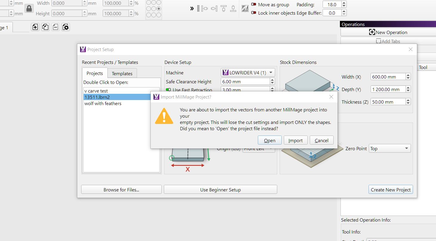

Drag and drop / import popup 0.9.00
just tried to drag a LB file into 0.9 and get this pop up
dragged it into 0.8.01 and didn’t get this, picking its something new thats been added , but thought throw it here just incase its a issue
and when i do import it , i have to go hunting for it , its not in project area
13511.lbrn2 (322.9 KB)
Today I clicked icon in tool bar MM starts recent folder pops up but it wont let me open files that i created yesterday
You should select “Open” if it is a .mage file. Then all the design details come in.
Import is for SVG, DXF, JPG, AI, and stuff like that.
As far as the popup when you drag-drop, I am not at the CNC computer to test but is likely. But I am guessing that was not intended.
thats what im saying mike the open button wont work ? :smiling_face_with_tear:
have tried same file in 8 and it opens sweet as in both instances

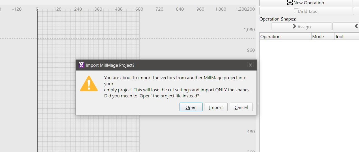

08 let me drag and drop, okay.
09 Open flashed the window and did nothing else.
09 Import loaded the Lightburn file like I would have expected for drag-drop.
DUH me!!! A Lightburn file has no Operations, so that window should be empty.
That begs the question: Why is drag-drop not working as expected? :nerd_face:
