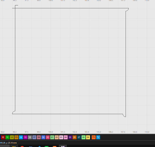

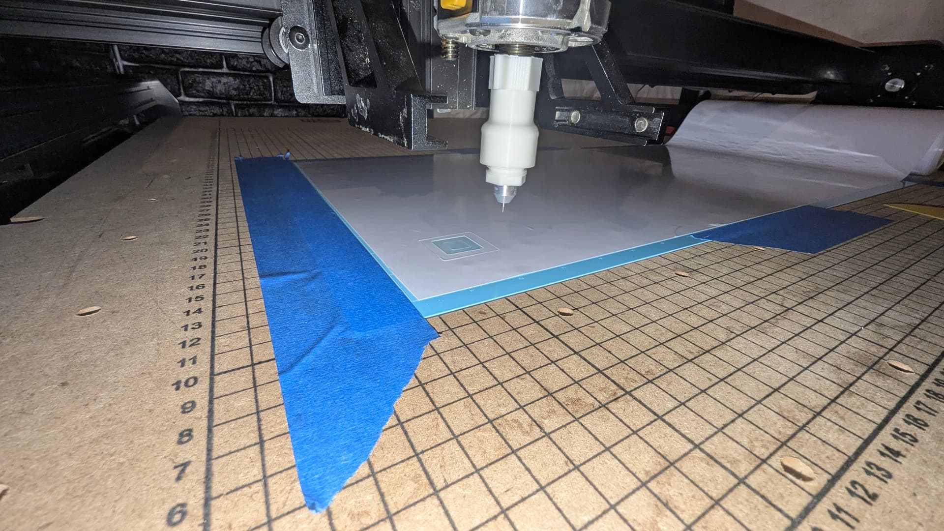

All,
Prepping for a 24hr Lemons Race in September and I need decals and numbers.

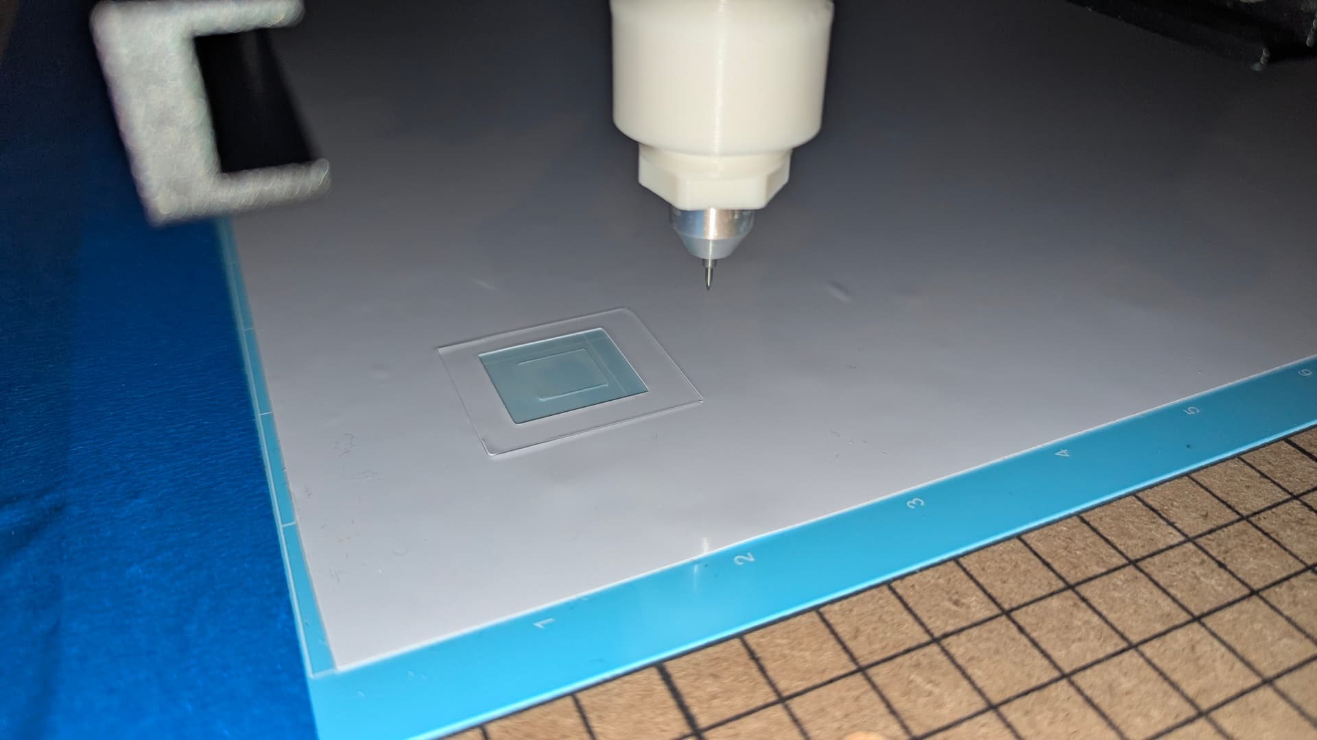

Bought a cheap Roland style drag knife and some vinyl.
Designed/3d printed a mount for the drag knife to mount to my Dewalt Collet with adjustable spring tension.

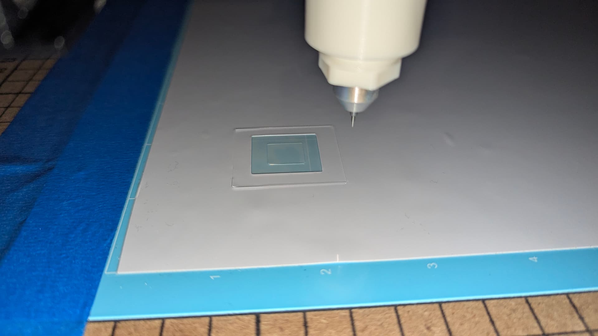

Having a radius problem on corners and curious if anyone could help with the current tool definitions or if there needs to be a new tool for drag knives. The blade of the knife is slightly offset from center, so the machine needs to go past the corner a bit before turning. (about 0.8mm past)

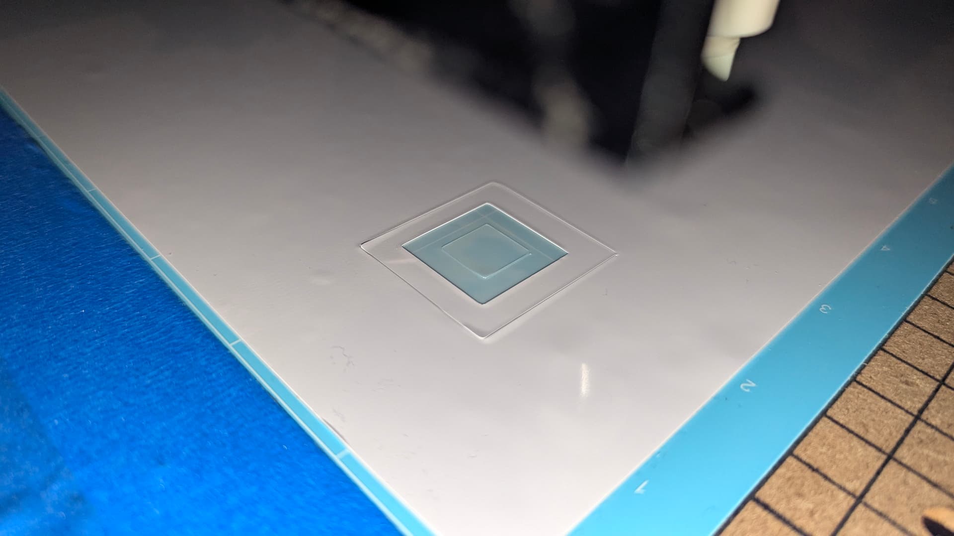

You can see in the photos that the corners are a bit rounded.
Any ideas to get crisper corners?
The other issue I’m having is if I have it cut the whole 0.8mm vinyl in one go, it’ll leave a little tab at start/stop points that doesn’t get cut. Possible to have it cut over the beginning point slightly?
I currently have it set as a single flute, 1mm diameter, 0mm corner radius.

Little tab: I think MillMage has a lead-in and lead-out option somewhere in there.
Sharp corners: Not possible. Think of a car pulling a trailer or you dragging a piece of rope. Turn the corner and the trailer tracks the inside of the car tracks. Draw it on paper and you will see what I mean. I do not think drag knives were ever intended for precision cutting.

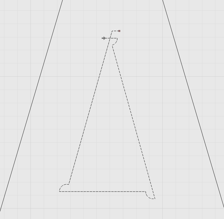

The sharp corners can definitely be improved. The blade just has to go past the corner the distance of the blade offset. The offset is how much the tip is offset from the center of rotation. As it drags past the corner, it aligns the cutting part with the next line. It then curves to the next line and continues having the cut align square and perfectly with the next line.
Lots of other software can do it. VCarve, Fusion 360 with an add-in, KiriMoto, cricuts are pretty dang precise, ESTL cam, etc…

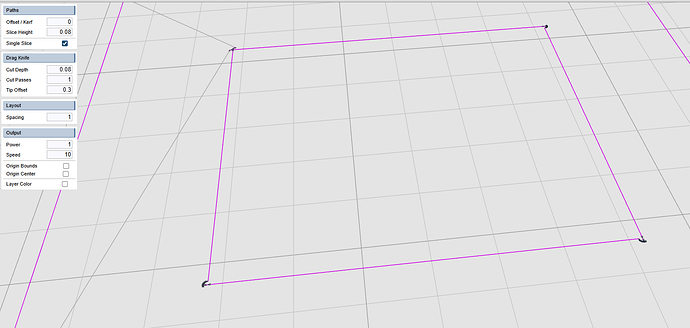

I played around with a bunch of things last night. Most promising(Free) seems to be Kiri:Moto. See attached for what Kiri:Moto made and the imported sketch into millMage.
Seems like millmage could do this pretty easily with a tool offset or new tool type.
A little more advanced feature; when going around a tight corner, the material will tend to bunch up. So most of these other softwares have a feature where the knife lifts out a little bit so just the point is touching at the corner as it rotates. When continuing on, it plunges back down.

Yes, but then the line after the turn will be in the wrong location. You would have to backtrack the offset before proceeding in the new direction. I imagine the drawing would need a spike at each corner.

Also, you find those Kiri:Moto corners acceptable?
Absolutely!

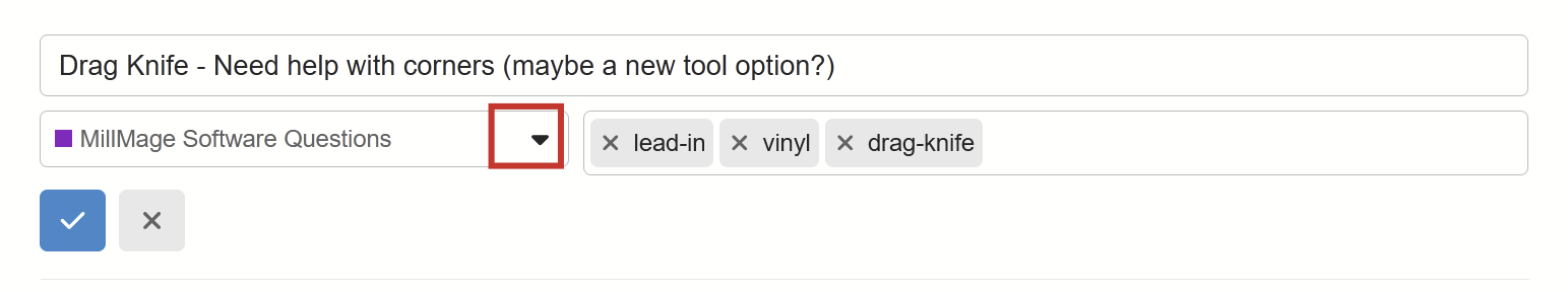

To change the Category of a thread, select the pencil icon in the title:
and select the new location in this drop-down menu:
I already changed this for your last topics.

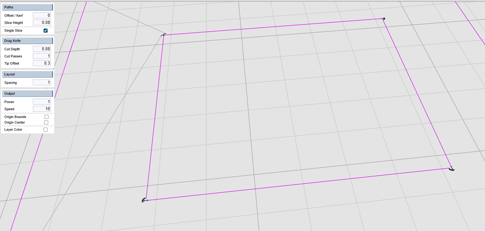

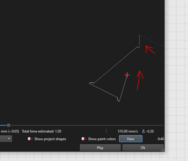

Noticed another bug with MillMage! I’m on the latest 0.8.00 RC5.
Cutting out names of my drivers - created in Fusion 360, then cut lines created for the drag knife in Kiri:Moto.
Sometimes, the cutting direction will be opposite of what is notated in MillMage as the start point (can be seen in the preview). It is only fixed when I go and switch to the opposite end starting point and switch back to the original start point.
Please upload your .mage project file, so we can see the designs and settings you used.
If possible, include the files you exported from Fusion / Kiri:Moto.
See attached for both of those!
The issue occurs on the middle and top names. All of them show as clockwise direction, but middle/top are cut in counterclockwise until manually switched & switched back.
