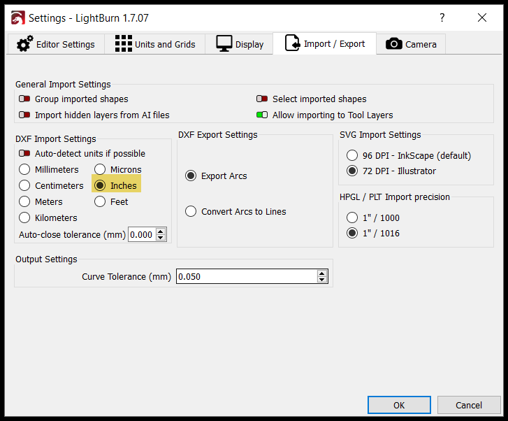

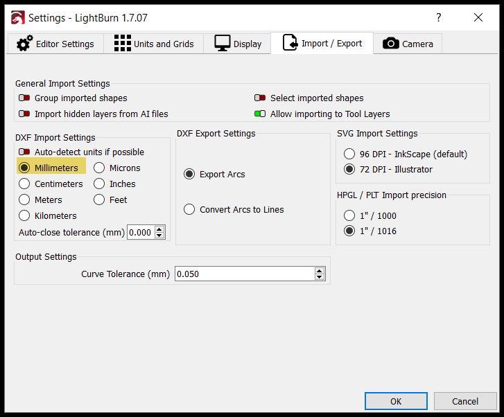

Since you say it works with your C02, go to the Import/Export tab in settings and see how you have it set for the C02, then make the necessary change in the same place for your diode.
If you’re importing DXF files, then:
In some cases, auto-selecting the units doesn’t work: we’ve seen cases where it picked “microns” instead of “inches”, with hilarity ensuing. Explicitly setting the appropriate unit for a specific file will help.
Are your AutoCAD drawings designed in mm or inches?
If your AutoCAD file is designed in mm, then
If your AutoCAD file is designed in inches, then

Ednisley,
thanks, that cracked it. I had selected mm but not deselected autoselect.
