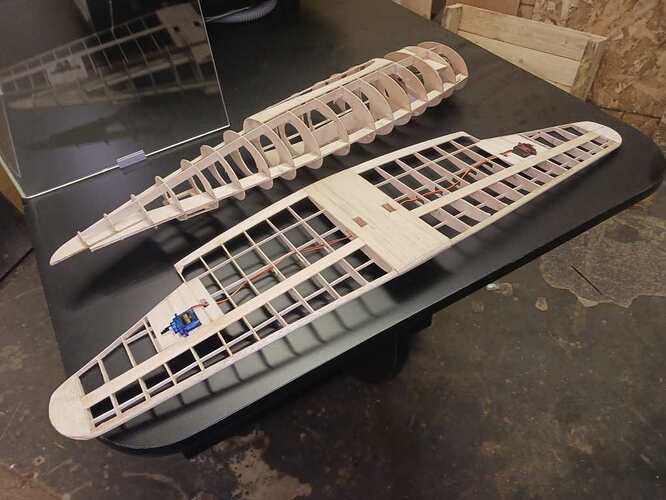

I’m 10 days into learning LightBurn and my first test pieces came out flawlessly. I used it for something more formal I can use, in this case some RC plane parts, and it’s best with balsa to lower the power and speed and do several passes in order to be gentle on the stock.
When I did a run of the parts, each pass shifts. Showing the final pieces I am going for, and did by just bumping up the power, but hardly the quality I was getting by lightening the load of power and just doing several passes on the same stock for a more crisp, less burnt cuts.

From this description and the perfectly clear picture I have a pretty solid guess…
The small set screws or grub screws in the pulleys can shake loose and one run is perfect and the next one starts to lose position.
If the offset images are on the x-axis, I would be looking at the x axis motor pulleys and belts. You may not see the loose grub screw, but tightening all the screws with an Allen wrench will let you feel which ones became loose.
This makes sense. Thank you for taking the time out to help! I’ll be going back over both the screws/bolts, but also the tension in the belts, pullies and wheels that are wrapped around the extrusion. You saved me from a lot of headache with this direction!

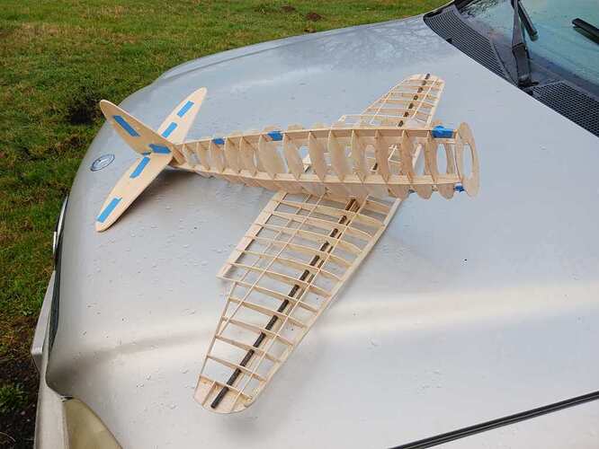

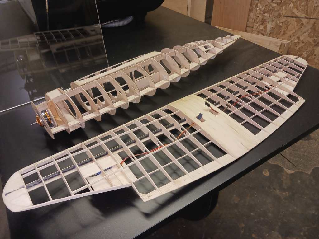

Sharing the current progress on the plane, where these pieces, in this landing gear fairings are eventually going to be installed in. All hand cut and plans I made for scratch building, slated to be converted into lightburn for free, for others to use.
