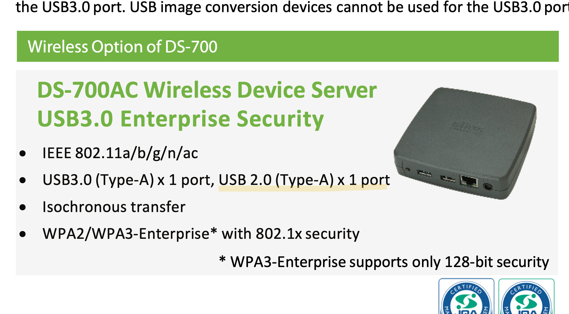

If the direct connection works it must be something about the DS-700 that is the problem, are you using the USB3.0 or USB2.0 port? try both, but you might have more luck with the USB2.0 port:

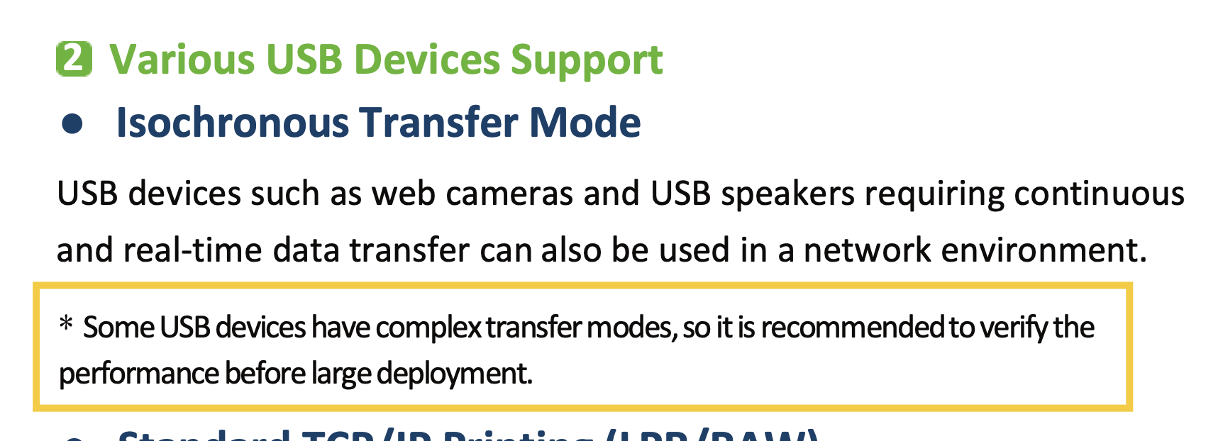

Or, there are “complex transfer modes” the DS-700 cannot handle:
