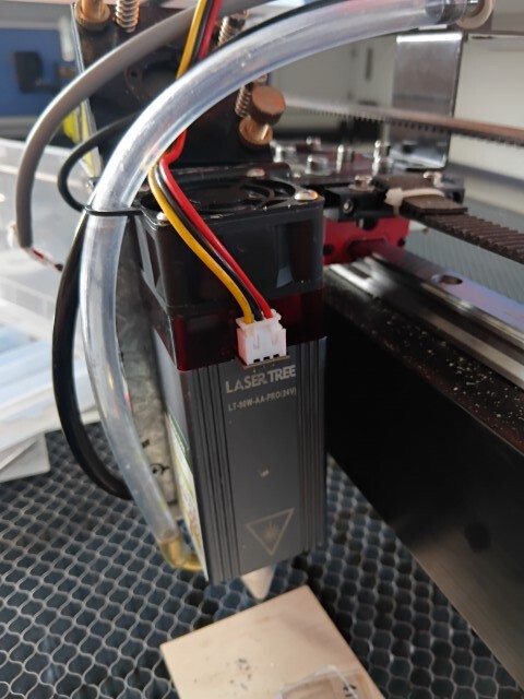

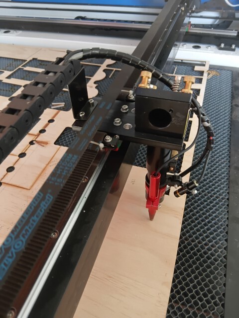

For a while now I have had a a 130w 1390 CO2 Laser. I have been very happy with its cutting ability, however for fine laser engraving it does not work so well. Call it “Walnut with a Sledge Hammer” syndrome.

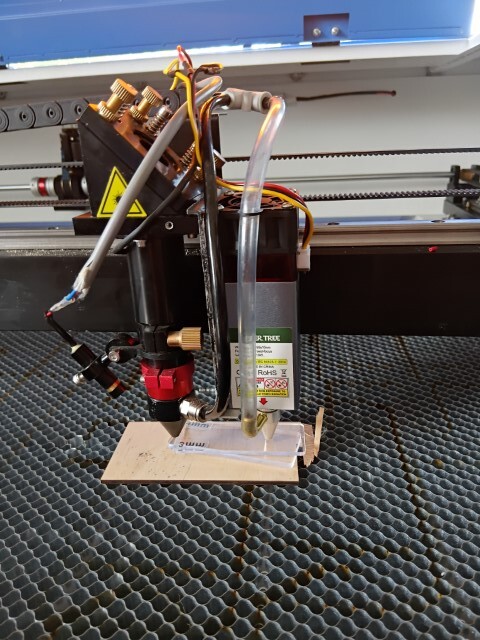

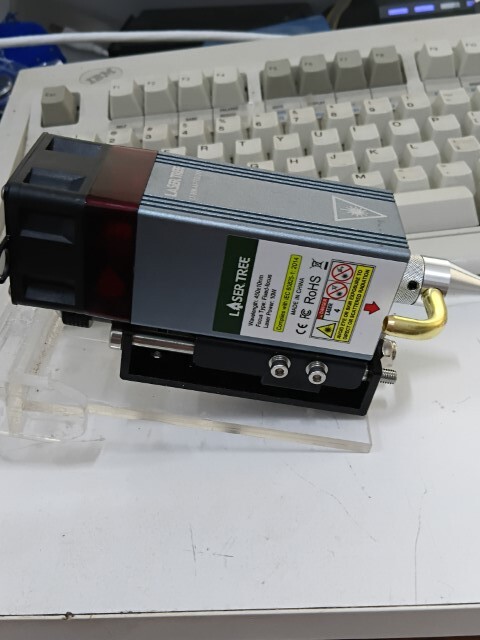

Looking at the mounting for the focus lens I noticed that there was a place I could mount the LED laser.
As there was plenty of clearance it seems the best place to mount it.

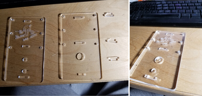

So I purchased a Lasertree LT-80W-AA Pro.. which has 2 x 5w blue lasers, and a adjustable slide to mount the laser on. Then using 4mm acrylic I bade a mount for the laser.

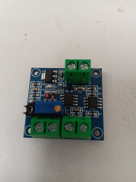

I did find some 555 based Voltage to PWM.. (Pictured Here)
But I found it would not produce PWM till at least 1.5v.. And I needed a higher range than that.
But I could use a microcontroller to do this for me.

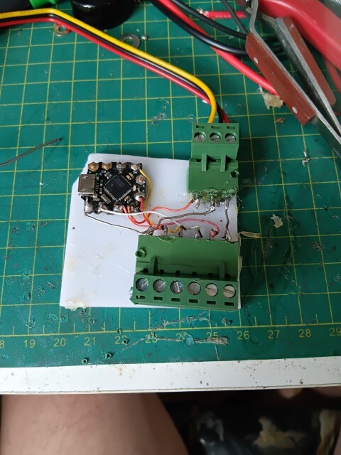

Using a DF-Beetle (Arduino Leonardo) controller I could program it to handle the safety AND the V to PWM convertor.

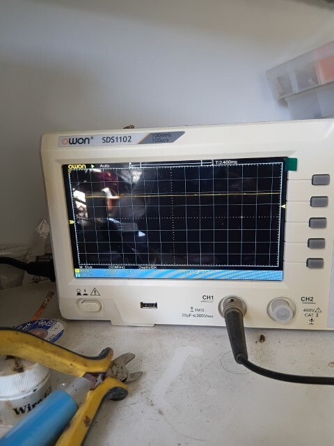

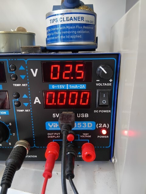

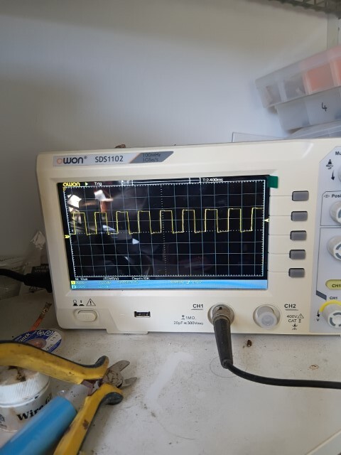

Here are some tests showing the Voltage in.. and the PWM.
2.5V
4.9V

Can you point out why you can’t just use the pwm the Ruida produces? It produces the pwm and analog voltage that are supposed to be directly related.
Maybe what I’m missing is how it’s wired up and how you tell it to use the visible light over the IR?

The focus for the CO2 tube is via a little pointer led.
The focus for the Blue laser is to turn it on slightly.
The part of which is confusing to me.
The little pointer led, is not the co2, which is ir and not visible. I was just differentiating them from each other.
Go snooze… happy dreams :yawning_face:
V to PWM. Voltage to PWM convertor. As the voltage chages the Pulse Width Modulation changes accordingly.
The little pointer led is RED. Not IR. Its one of those cheap red laser you can buy for cents.
Its on the CO2 side in a little holder that indicates where the IR CO2 beam will hit.
I know what you’re doing, I’m just wondering why.
There are two outputs from the Ruida, one is analog, the other pwm. You have pwm generated by the Ruida, so what are you doing to make this work?
Ok. I only used a multimeter… not a scope for checking the output as other articles showed the laser power supply onlyvaccepting an analogue input. I.e. connecting a potentiometer between GND, 5V, and the laser in.
But my design caters for the L_Low Safety signal, and the capability to drive the LED Laser at a very low level for positioning the work before cutting.

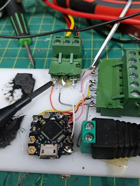

Ok.. Minor update. I have moved some of the connectors around on the V to PWM board.
Top from Left
Pin 1. PWM to Diode Laser
Pin 2. GND
Pin 3. 24V for Led Laser.
Bottom from left.
Pin 1. 5v
Pin 2. Gnd
Pin 3. Vin
Pin 4. L_Low
Pin 5. Focus On
Pin 6. 24v for LED Laser.
I can still alter the code using the USB on the DF Beetle.
Enjoy.

Nice project! I agree to the others, the PWM signal should be there already.
But apart from this, I wanted to mention that those laser gantries are usually not built to handle the weight of a diode laser head. You need to be careful when it is mounted, I guess you can damage it very fast when using high speeds etc.

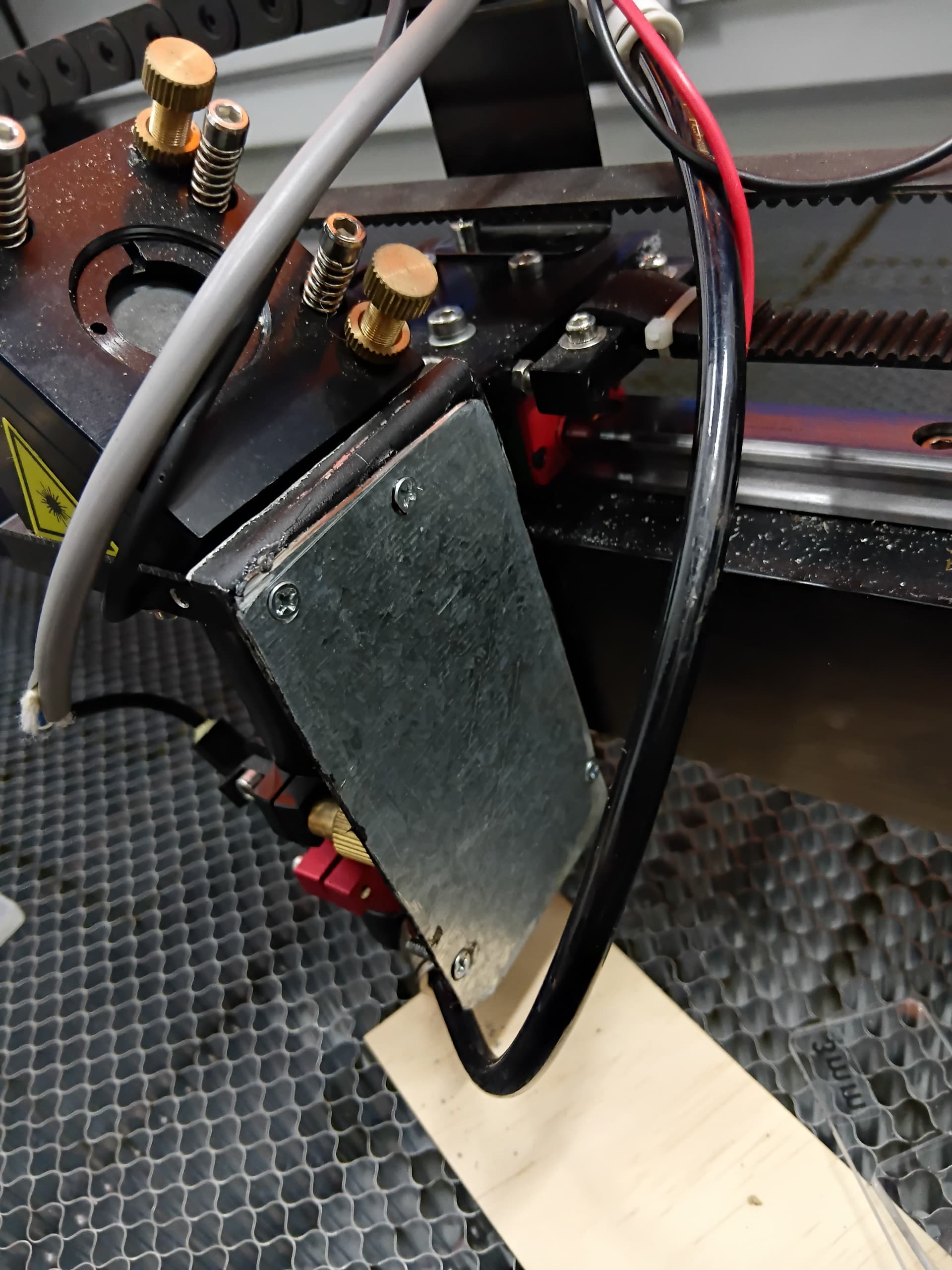

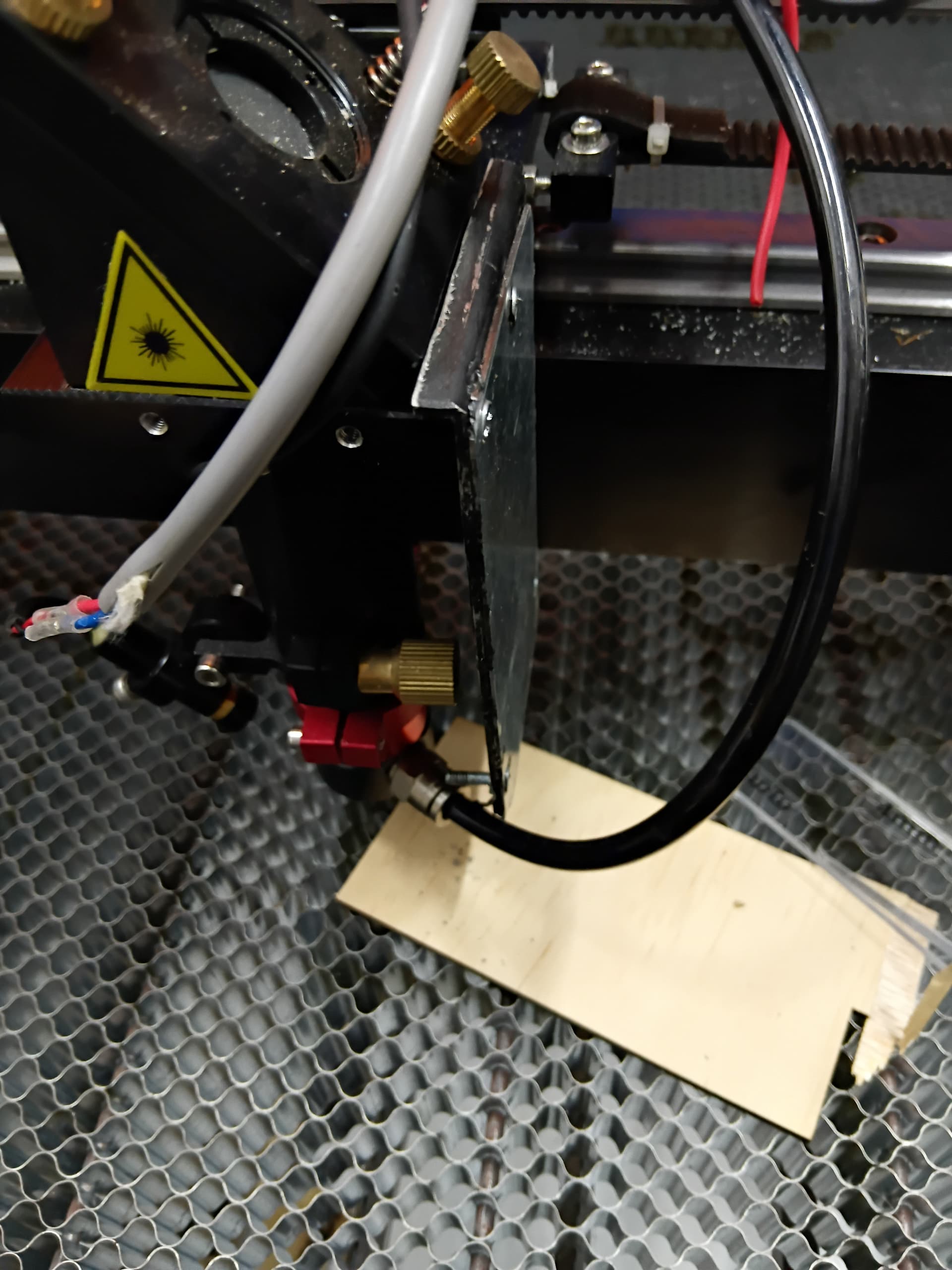

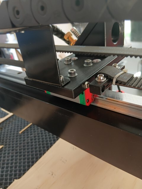

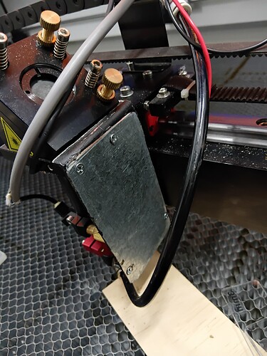

Minor setback.. my acrylic mount shattered :frowning: so I am remaking it in alumium. Plus with thin steel over one side so I can attach the diode laser with magnets.
I forgot the cable exit at the back of the X axis and that caused the issue.
New positio in on the front right of the fown lens and I have checked for clearences.
More soon..
You shattered the acrylic, do you think magnets will hold it? Personally I doubt it.
You’ll have to go out of your way to design something that will take a big machines acceleration and not have some kind of pendulum effect. I’m sure this acerbated the the issue.
You might have to just slow it down when you use the led laser.
Let us know about the new part and mount.
Good luck
Actually More ‘Popped the Superglue Joins’. I should have used proper Acrylic cement.

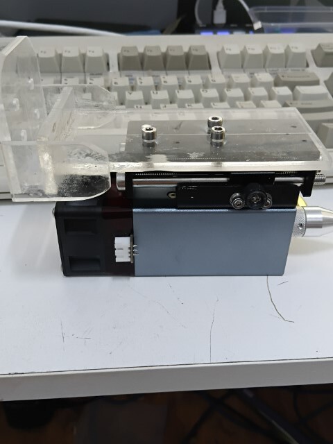

I have some pictures of the new mount..
How does it work?
When I did mine for a very small and cheap gantry laser, I doubled the 3mm acrylic and made t’s to align the two pieces.
I used an acrylic glue.

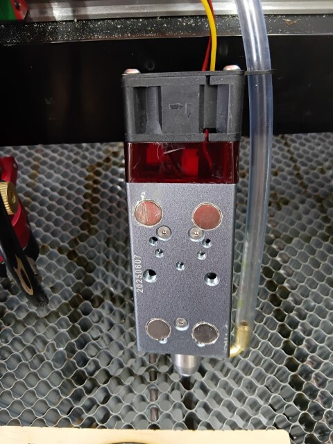

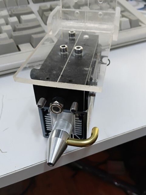

Hi Folks. Well the project is completed and I am VERY happy with the outcome. So here are the details.
After fixing the steel backed mount to the laser head I modified the Diode Laser and inserted 4 10mm x 3mm Magnets.
This was was easily done as the main laser assemble was fixed by the 3 small hex screws and it slipped out with the electronics.
When assembled it looks very neat.

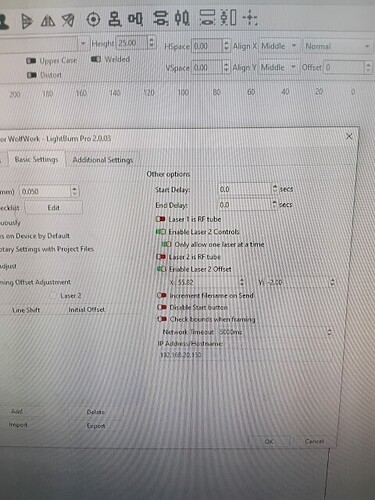

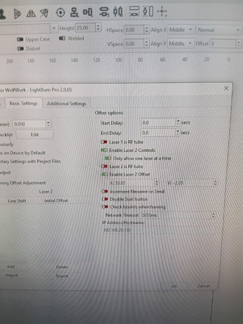

Lightburn was easy to set up with the Device screens
Note the Enable Laser 2 Offset as this tell Lightburn how to line the 2 lasers up.
I did a simple test for this by drawing 2 squares and adjusting until each square was aligned.
This was the Lightburn file

I ran it up to 500m/s and the diode stayed attached very well.
This would work OK but I still needed to attach and detach the diode laser easily.. So Magnets seem to work for me..
