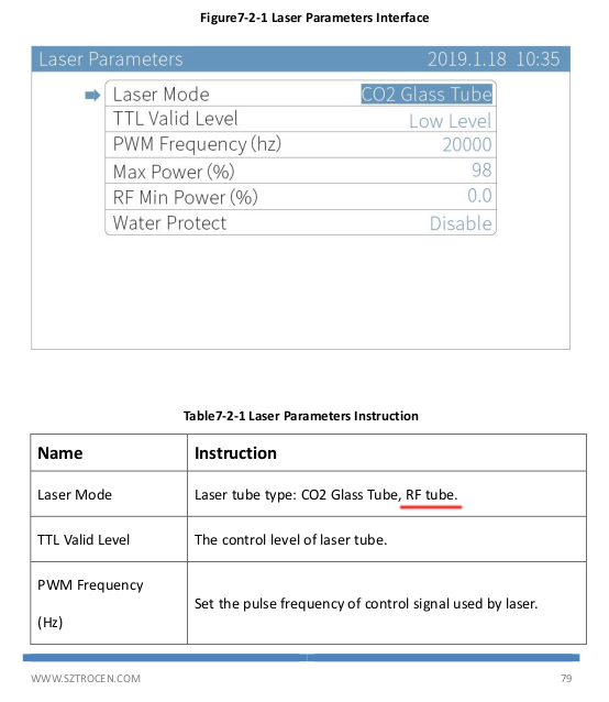

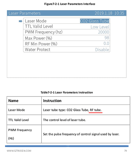

The Ruida will drive an led laser…
Go into the Machine settings and change it from Glass Tube to RF and it will only generate the pwm when needed. RF lasers use the same connections, power, ground and pwm.
L-On is usually referred to as laser enable, not laser disable… however, the end product is the same … :face_with_spiral_eyes:

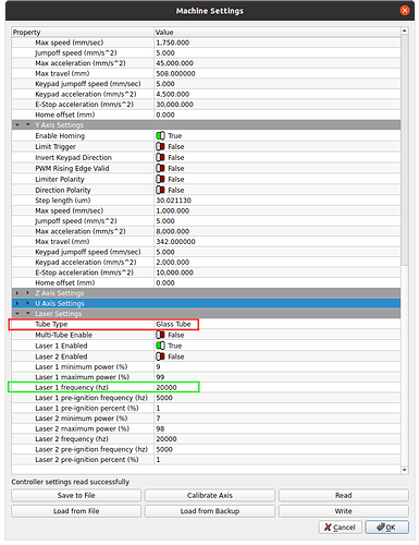

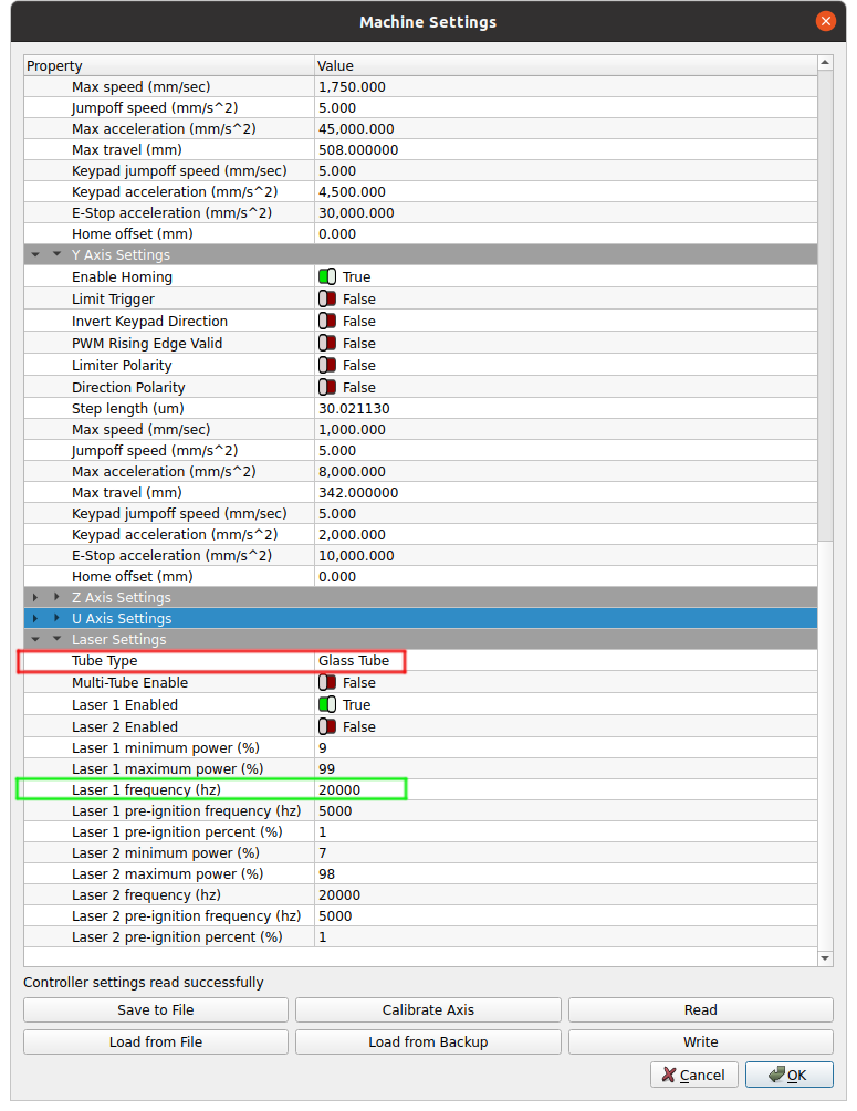

Hi.
I checked my Lightburn, and I have for the tube {Glass Tube, RF1 Laser, RF2 Laser}
Sadly my CO2 laser will only fire with Glass, which is an Analogue output.
I believe I can run my Diode Laser by converting the 0-5v to a PWM signal. As people often use ESP32’s (Nice for speed) to control the cheaper K40’s I could program one to do the following.
0.5v = 10%, 2.5v = 50%, 5v = 100% PWM with the frequency running at about 20khz.
Can you see any issue with this?
Many thanks
Dave

If you’re trying to run an led with a glass tube, the machine can’t handle that.. Sorry.
You must use the L-ON signal to enable / disable the diode, because the Ruida controller keeps the PWM signal running pretty much continuously during the job for glass-tube lasers.
Yes.. I will code the ESP32 to use this to turn the Analogue to PWM program on and off.
However I will still set the a Doide Laser to just work so I have a pointer to where the work is.
You can do this with a simple logic gate, no reason to waste a esp32…
The Ruida asserts L-On, drives a gate that allows a pwm to pass if it’s low To make things more easy, the L-On can be inverted within the Ruida. If you invert it, a simple and gate would work.
Sadly I still need to do a Analogue to PWM as my Co2 power supply will not accept PWM. :frowning:
What kind of supply do you have that’s analog only?
The common supplies we use can take analog or pwm ttl voltages as inputs. If you use ttl it gets converted to an analog signal anyway.

That’s a standard lps, so you can run the PWM to the IN terminal.
If you have glass tubes, then changing the mode to RF will disable the L-On output, so it won’t lase. A glass tube takes an IN current control voltage (or pwm) and L causes the lps to lase.
Ok.. So it looks like it is best to keep the CO2 as Glass, and then use a voltage to PWM for the LED laser.
