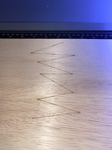

We had everything aligned and dialed in on both lasers before we attempted any work at all (but appreciate the methodical approach). Some combination of your suggestions and late night thinking when I should’ve been asleep led to a partial solution. I created two different files as if I were running a print and cut with the left section of the image moved the distance of the physical laser offset on the file (and no offset in the settings) and then just ran it with laser one turned to 1% (won’t run if it’s not enabled, but won’t fire if it’s below 10%). It worked reasonably well (not ideal but not atrocious. . . you can see the meet point along the 'center’line). I think I’ll just use it as one laser machine until I need to get wider than 45" and then I can spend half an hour dialing in perfect offsets. . .
