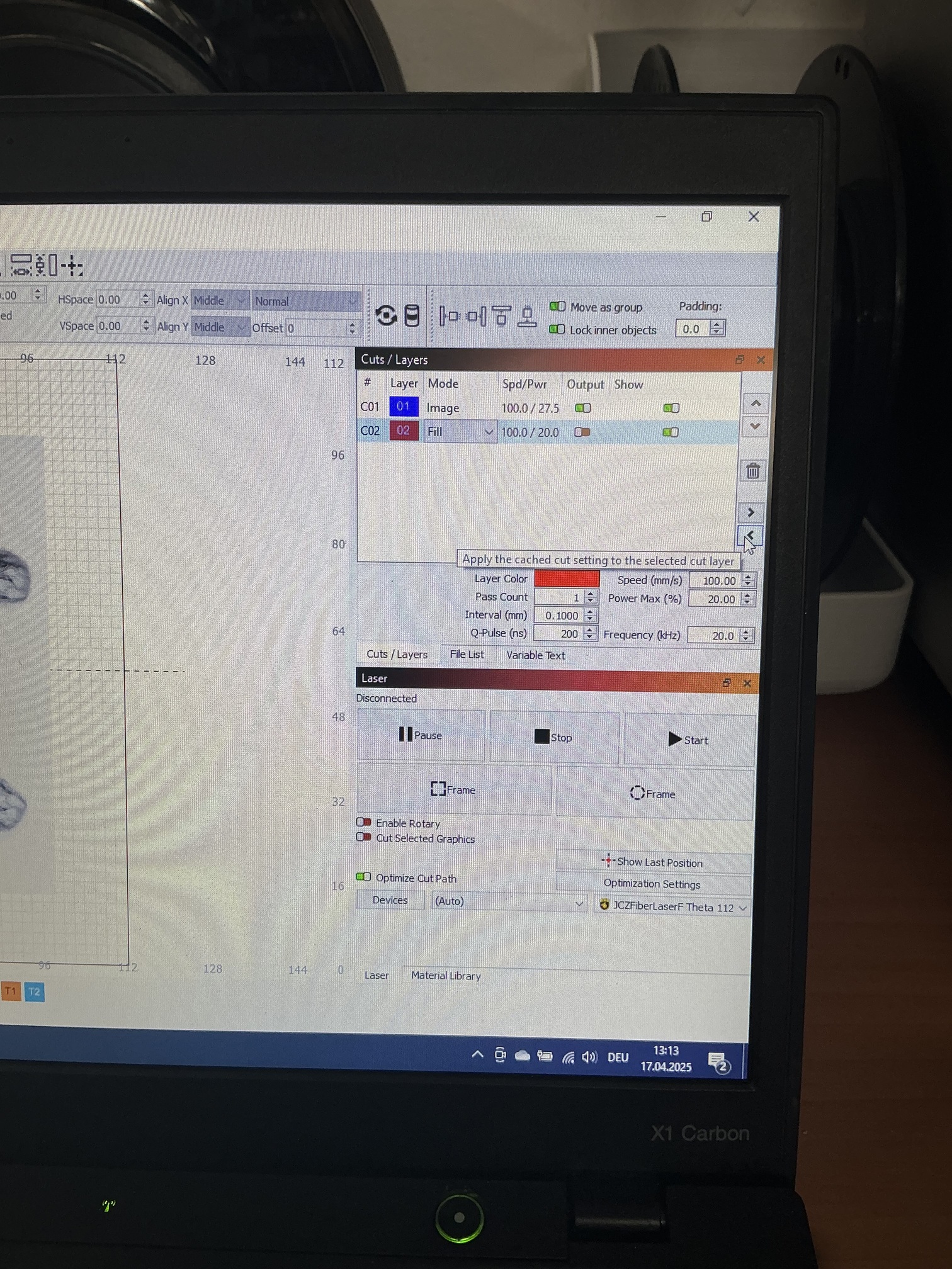

Hello to the Community,
I am new to lightburn ( LB 1.7.08 on Lenovo Laptop) and getting familiar with this software through your help in this forum and several videos .
I have following issue and hope somebody will help me.

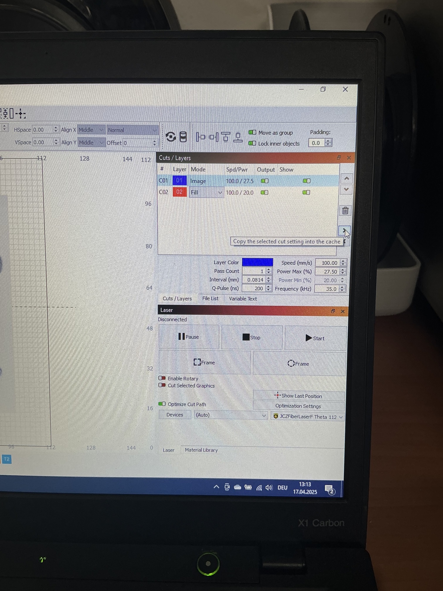

It does not work to duplicate layer settings from one layer to another as discribed in this forum with „cache“ funktion
The „cache“ function changes nothing(s.attached fotos)
I want to copy layer settings from C01 to C02 but nothing happens.
Does anybody know what I am doing wrong?
Regards
Stoandl
In your case, this does not work because your layers are incompatible. You can only copy and paste settings of the same type. Line / fill modes are vector modes and image is a pixel-based mode. You can only copy and paste settings within line/fill or image modes, but not between image and line modes.
