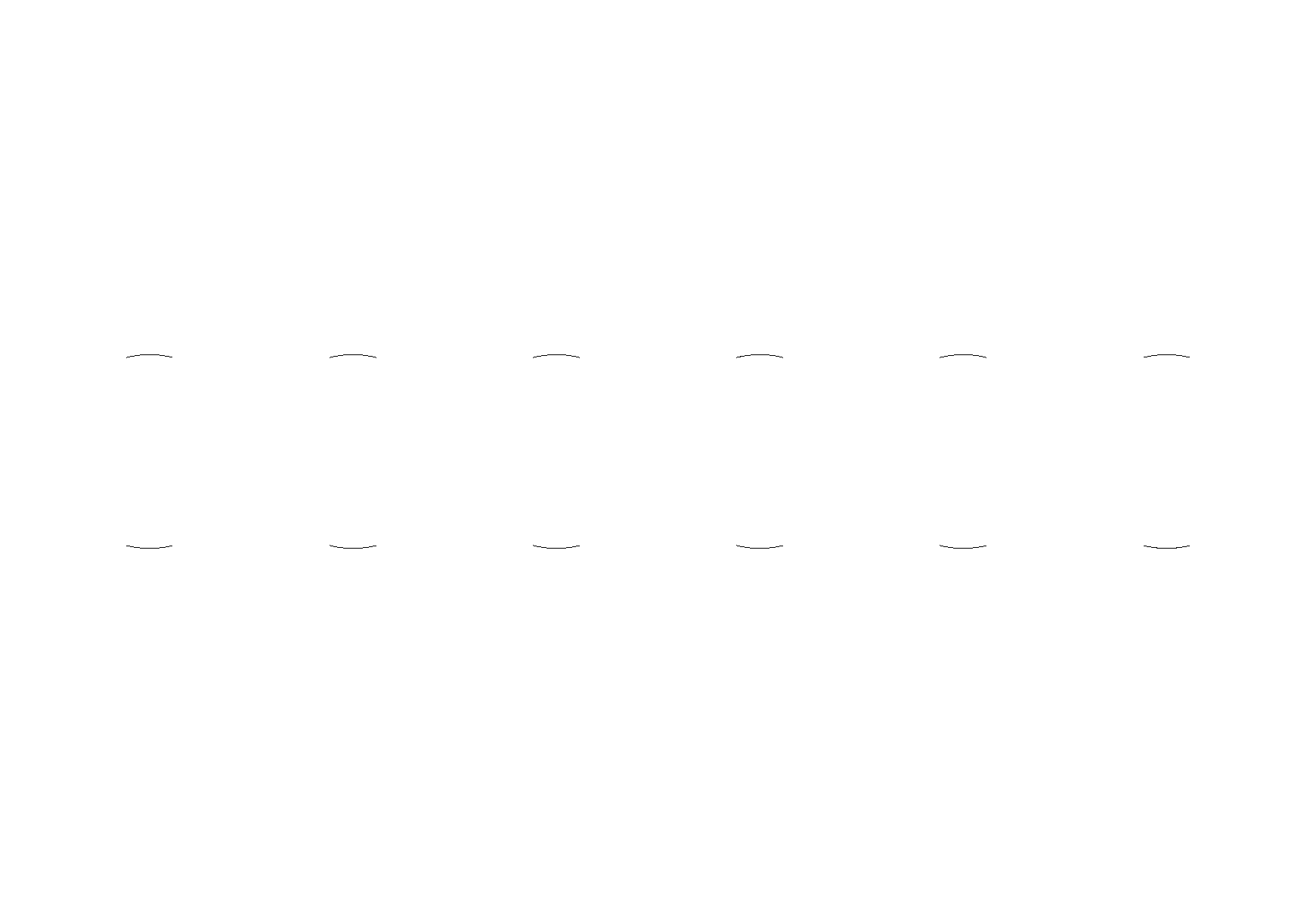

Hi Guys, I have a set of circles with tabs. 2 tabs per shape and 40mm tabs.
When I duplicate the circles I get weird arcs (see pics)
When I duplicate again (triplicate), I get more weird arcs but they change with the normal ones staying on top. trying all sort to stop this behaviour
maybe you can throw me a hint.
Sorry if this doesnt make sense.
Basically i cannot duplicate or make an array or 36 circles of 30mm diam (6x6) without freaky tabs.
to duplicate this, just draw a 30mm circle then preview full circle. then enable tabs then preview again, most tabs that are 5mm but some are look to be 2mm. (see bottom row 2nd from left, top tab)
now if you set those tabs to 20mm or 40mm things get even weirder.
Help please.
Thank you for reporting this, but I am not able to get the same result. Here is what I did:
  • Draw 30mm Ellipse without Tabs enabled
  • Preview shows full circle
  • Edit Cut Settings to enable Tabs
    –Tab Generation = Automatic, Tab Size = 5mm, Tabs Per Shape = 2 (shown in image below)
    -Preview shows tab cuts as expected
    -Using selected circle, build 5 X 5 Array
You can clear all tabs and try again without the need to rebuild the array.
I went in and changed the Tab Size to 20 mm.
And 40 mm as well.
Show your ‘Cut Settings’ and maybe post your .LBRN file, and we can take a look.
hmm, weird ok. Yes I will post the file and cut settings

followed your steps exactly and same weird result for me
see tabs in top left one and bottom tab of top right one and2nd row down, forth from left top tab
then cleared tabs and did 20mm
then cleared tabs then chose 40mm tabs
error50520mmtabs.lbrn (43.6 KB)

I see the issue in your file, now trying to understand why.
Any ideas, 90% of all my jobs are circles with tabs lol, its driving me nuts. Its weird, sometimes even getting stray straight lines coning off the arcs
I’m working on a fix right now. Just trying to make sure I’m not breaking anything else.
BTW @NTBee I would love to know why you are making 40mm tabs? Honestly, I didn’t mean to let them be any bigger than 10mm - at 40mm they aren’t really tabs anymore. Understanding your use case better would be helpful.
Progress!
@NTBee fix is pushed and will be in the next release.
