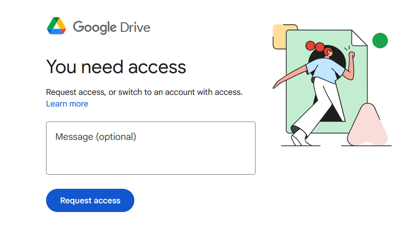

Thanks. Unfortunately I’m not able to download it as the permissions haven’t been set to allow it.
Yup - ditto. Tried to open the file to check it, but can’t.

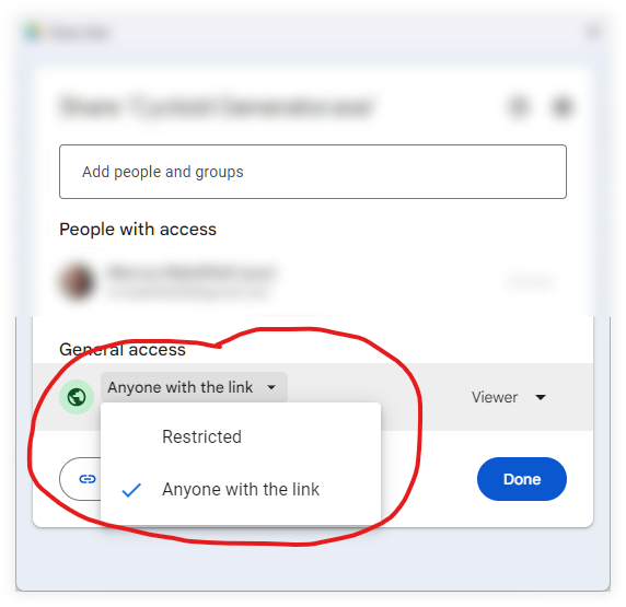

I’m still unable to get in, I get the same page as before. It’s probably academic now anyway as you’ve undoubtedly got the best person helping you to be honest.
To allow anyone access, the permissions need to set like this:
