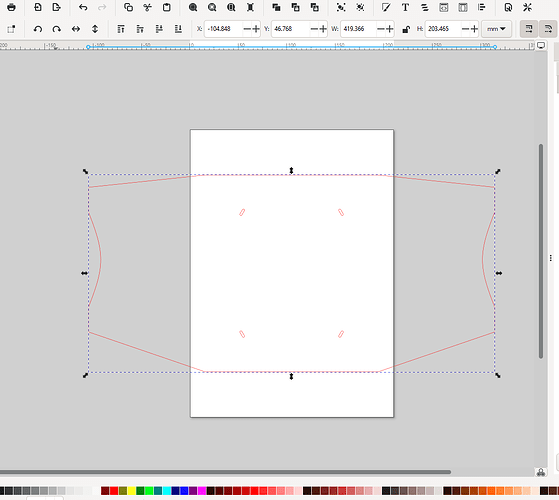

I imported your DXF into DraftSight as well as CorelDraw 2018 and it imported ok into both. I re-exported it as DXF from Corel and that imported just fine into LB:
I’ve attached the re-exported DXF in case it’s useful.
R14 last - Re-exported from CorelDraw.dxf (174.2 KB)
Hope this helps.
EDIT:
It also imports into InkScape.
For some reason those 4 little “tic-tacs” are causing problems. They’re using ‘vertex bulge’ properties that appear to be out of range - looking…
The straight sides of those tic-tac shapes are stored as very shallow arcs, below the precision of my codes ability to represent the numbers properly, and it was blowing up the code that generates the arcs. I’ve added code to detect this and just switch them to lines.
And it’s posted - Go to our Public Beta site (click < that) and download the 1.4.04 version for your OS and it should import fine.
