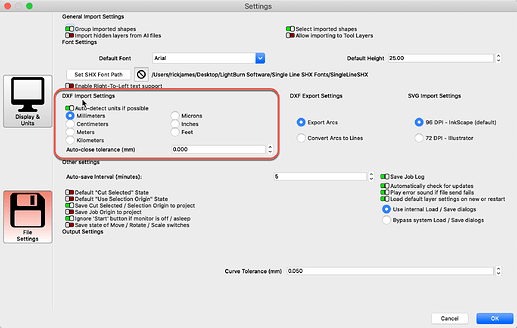

And, (click ‘Gears’ icon near top-center to open ‘Settings’)
DXF Import Settings
DXF files do not store the measurement system that was used to create them. If you create an object that is 5 inches wide, it might import as 5mm wide, because LightBurn can only see the ‘5’. Similarly, if your object was created in microns, it might import huge. Set this value as appropriate before importing DXF files to ensure correct scaling.
