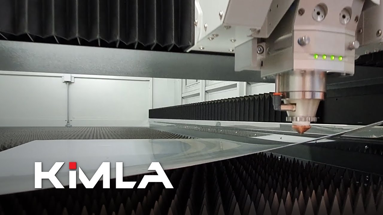

I came across these things on youtube called “Magclips” and you can download the 3d printable file on Thingiverse. The simple low-profile design eliminates you from crashing into them with your laser. Just do a search on magclips on Thingiverse. His video is on that site as well. Hope this helps.
It doesn’t sound like there is interest/need for any “low-tech” solutions here. Why not just buy a ready-made “professional” solution?
It might not be as fast as the one in the video, but for plywood it sure does, and all for under $100.
Do you have any idea how close to the work the laser would be at it’s strarting point ? Thank You
Uh, that’s the shipping. The tracking head is closer to a kilobuck.
