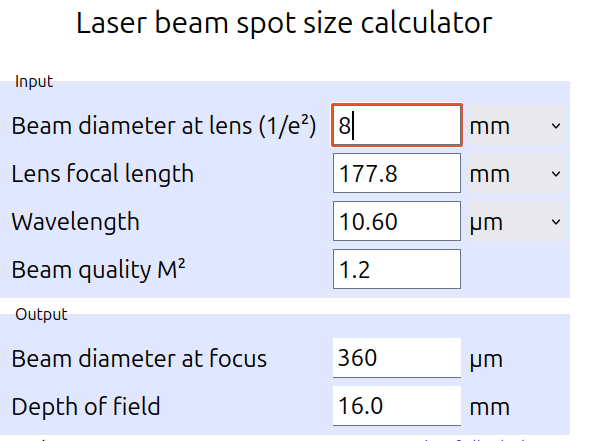

I doubt any laser has a 20mm depth of focus. You have a CO2 machine, so maybe a 4” lens might be able to give the cutting depth needed.

You can find long lenses for co2 machines, but anything over 4” is more difficult as that’s usually outside the range of what places stock or carry.
The other issue is the size of the input beam. A 4” lens has a spot size of about 206 microns (0.206MM). Laser with a 10mm input beam into the lens it changes the spot size to 165 microns, but the depth of focus is less at 3.34mm.
This is computations using a 7” lens, that I’ve seen for sale.
This is an on-line calculator.
