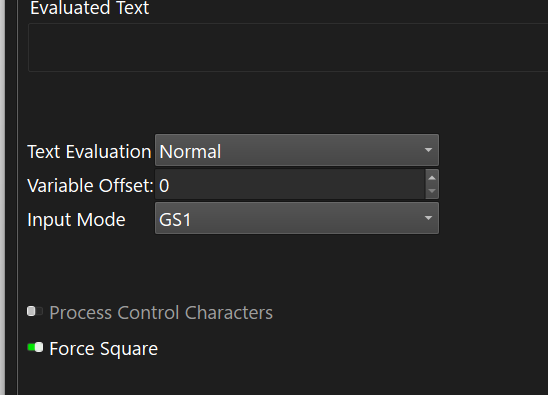

I believe this is just the GS1 setting in the Datamatrix option of the Barcode generator
But entirely willing to be wrong, let us know.

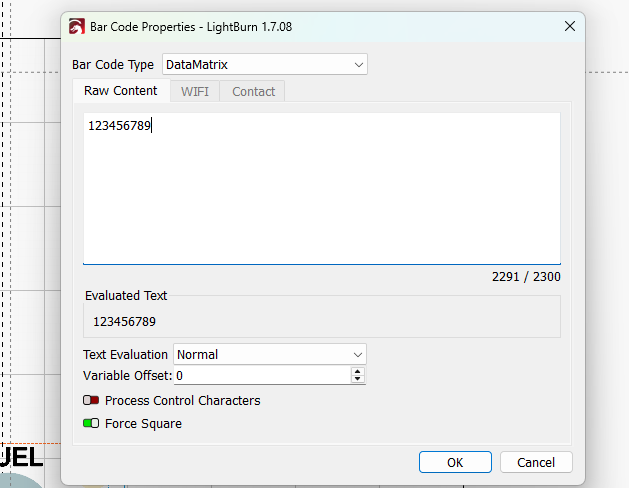

That’s odd, when I go to the QR code generator, and select the DataMatrix, I don’t get an option for the GS1. I don’t even get the input mode option. My software is up to date too.
Try our latest release candidate for LightBurn 2.0 - Public Release Candidates – LightBurn Software
I’m using 2.0 RC6
I didn’t even know about this! Thank you!
