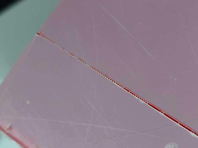

Right, the issue is with the finish i am getting on edges of ALL materials.
Pictures attached are mostly of 3mm Red acrylic as its what i had the most of to waste. But it happens on MDF/Woods too !

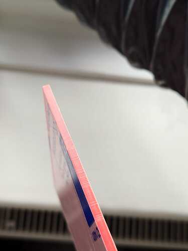

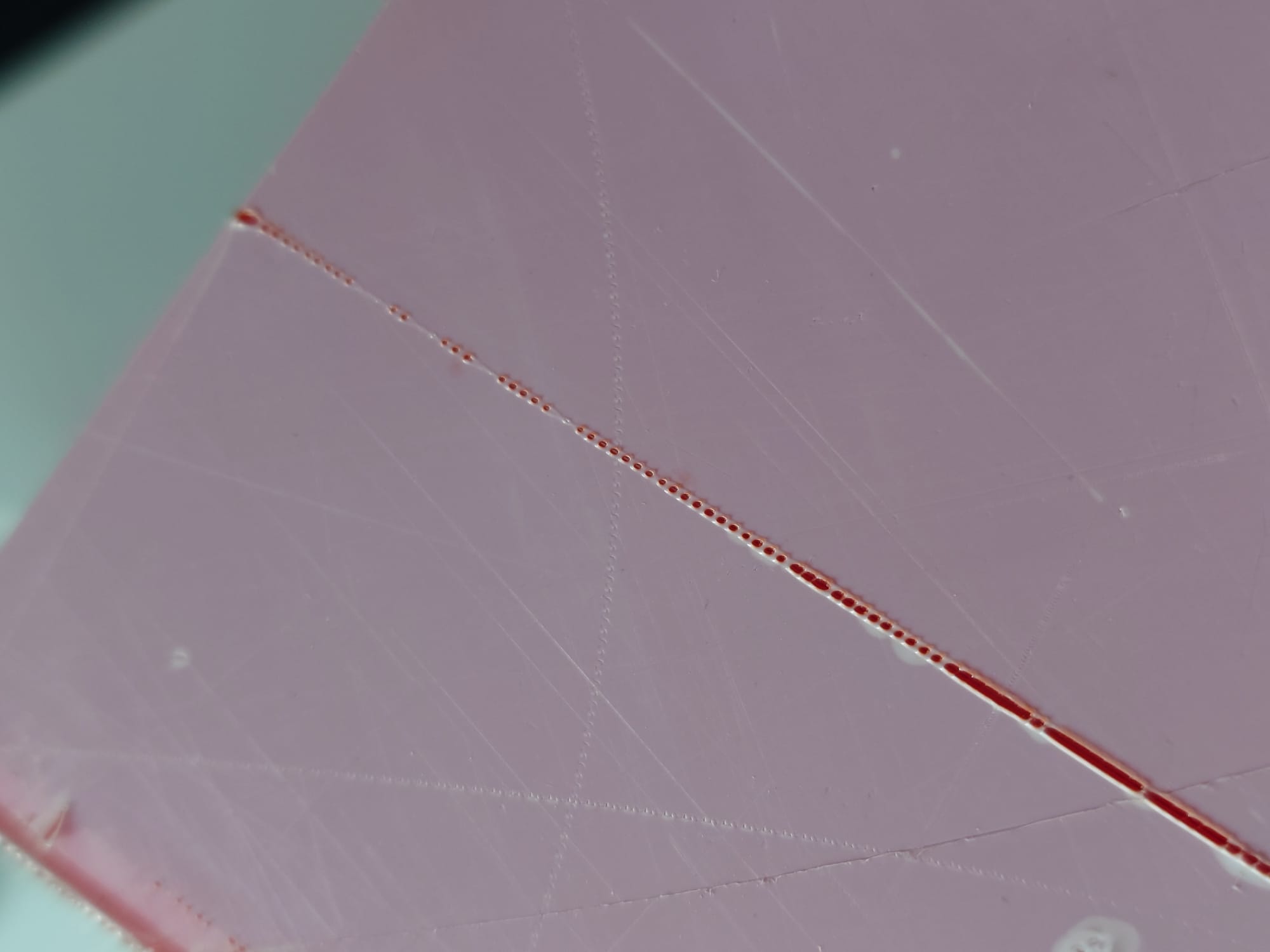

For this red acrylic, im using 10mm/s and 60% power. This cuts through fine but the edge is far from smooth.
The edge has a similar finish even after slowing down/ speeding up / more power / less power.
I have tried so many combinations down to 3mm/s and up to 20mm, power up to 95% etc
Using the suggest setting from Gweike gives this finish on the back, which almost looks to me like the beam is either changing focus or power and not making it all the way through ( almost like up down up down power, if that makes sense )
All the above have been straight lines ( rectangles ) to try and rule out stepper motors.

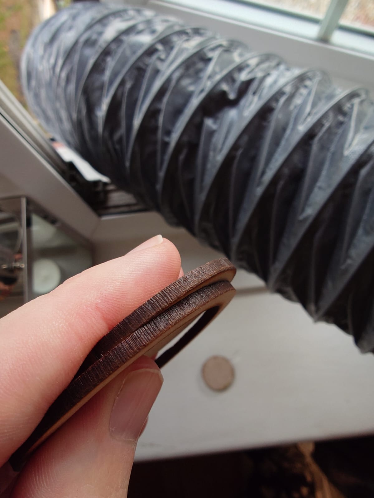

The below is the finish on MDF and a circle.
Please help me. Gweike are telling me this finish is normal but this is not my first laser and I know its not.

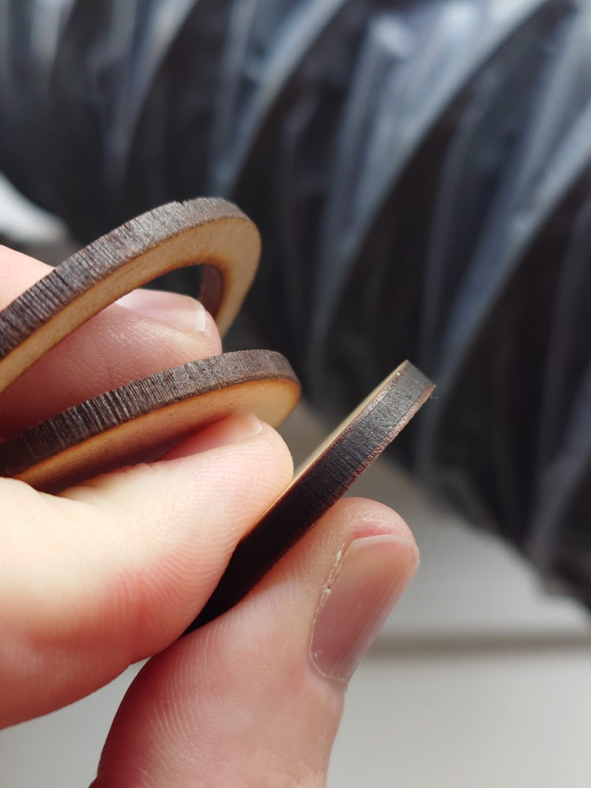

Just to add, this is an MDF circle from another machine ( not Gweike ) but with almost identical settings. You can see the 2 cuts from the Gweike in my hand also. The difference is night and day !

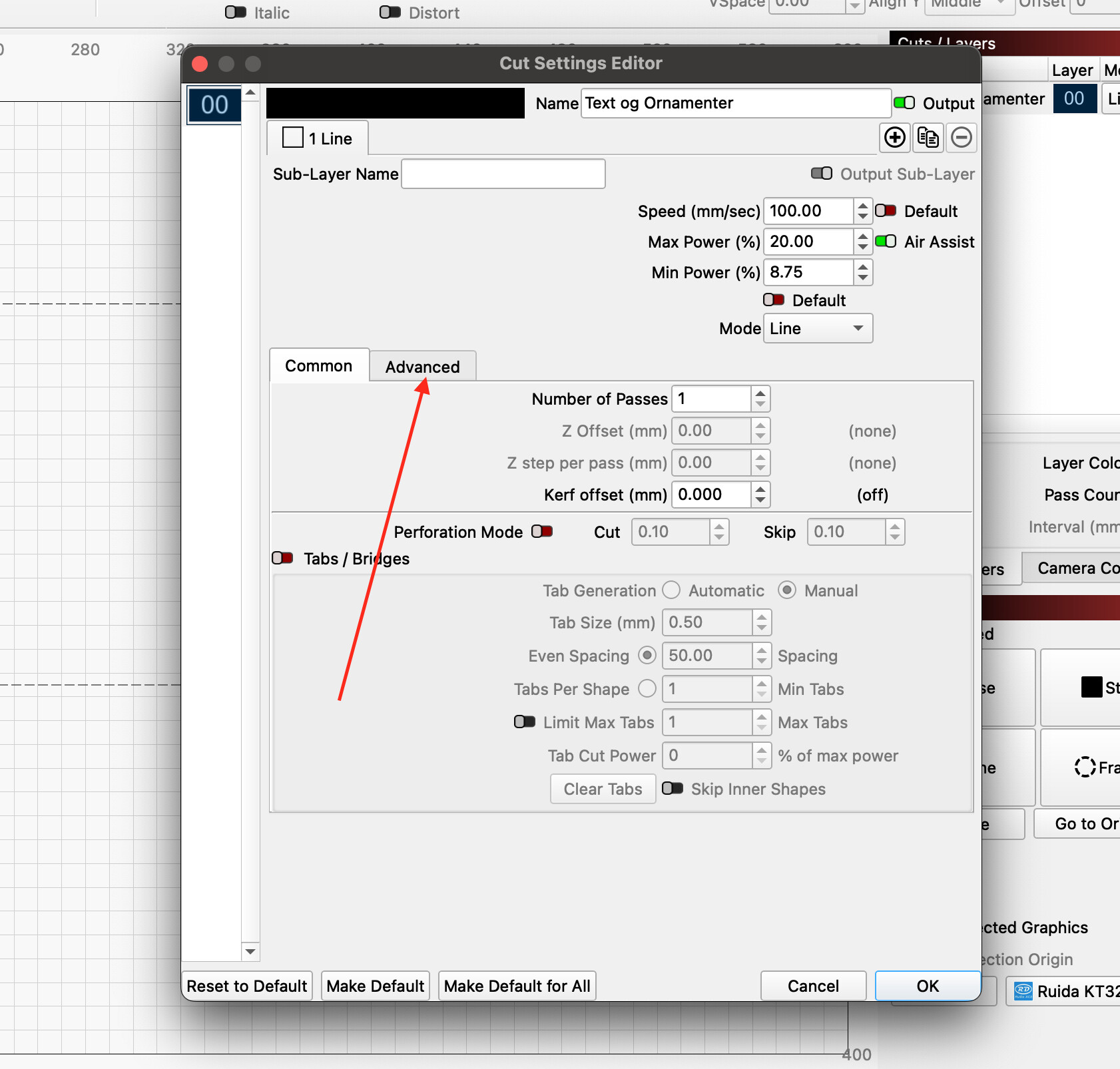

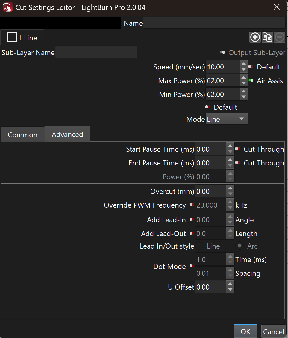

Can you show your LB settings for this layer?
That’s a very amateurish statement - from a laser machine manufacturer/seller.
Not a reply I expected either if I’m honest. The second reply was " try these settings 10speed 90power" which as I had already told them made no difference, but I did it anyway and showed the results.
Which settings were you after?
both of them
Just to see what we’re talking about…
Here you go,
Do you use Z offset when cutting acrylic? …minus 14 mm…?
Other than that, my settings for my nominal 60 Watt laser are 57.5% power, approx. 13 mA but 22.5mm/s in speed and I have a nice cut edge.
That’s how it works on these apparently, so that’s what I’ve been sticking with. 17mm less the material thickness. It works for me and the focus is spot on. It’s just the poor edge that driving me mad.
